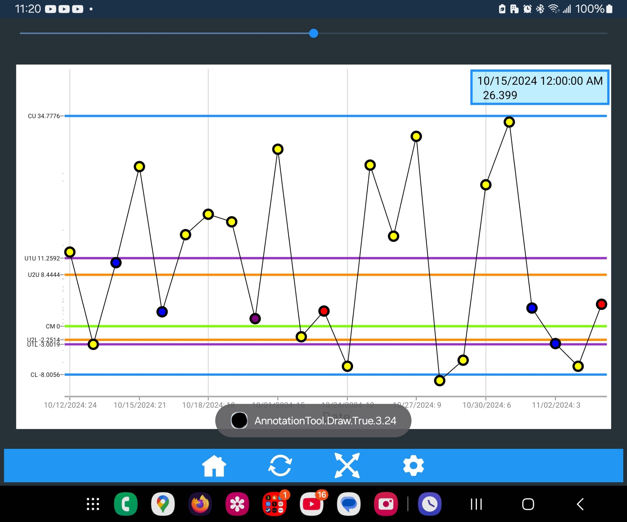

Post by TLC » Tue Nov 05, 2024 5:29 pm
Here is a screenshot of so you can see it. The toast on the image is to help debug it.
In this case, the arrow should be from the bottom left corner of the popup to the 3rd point.

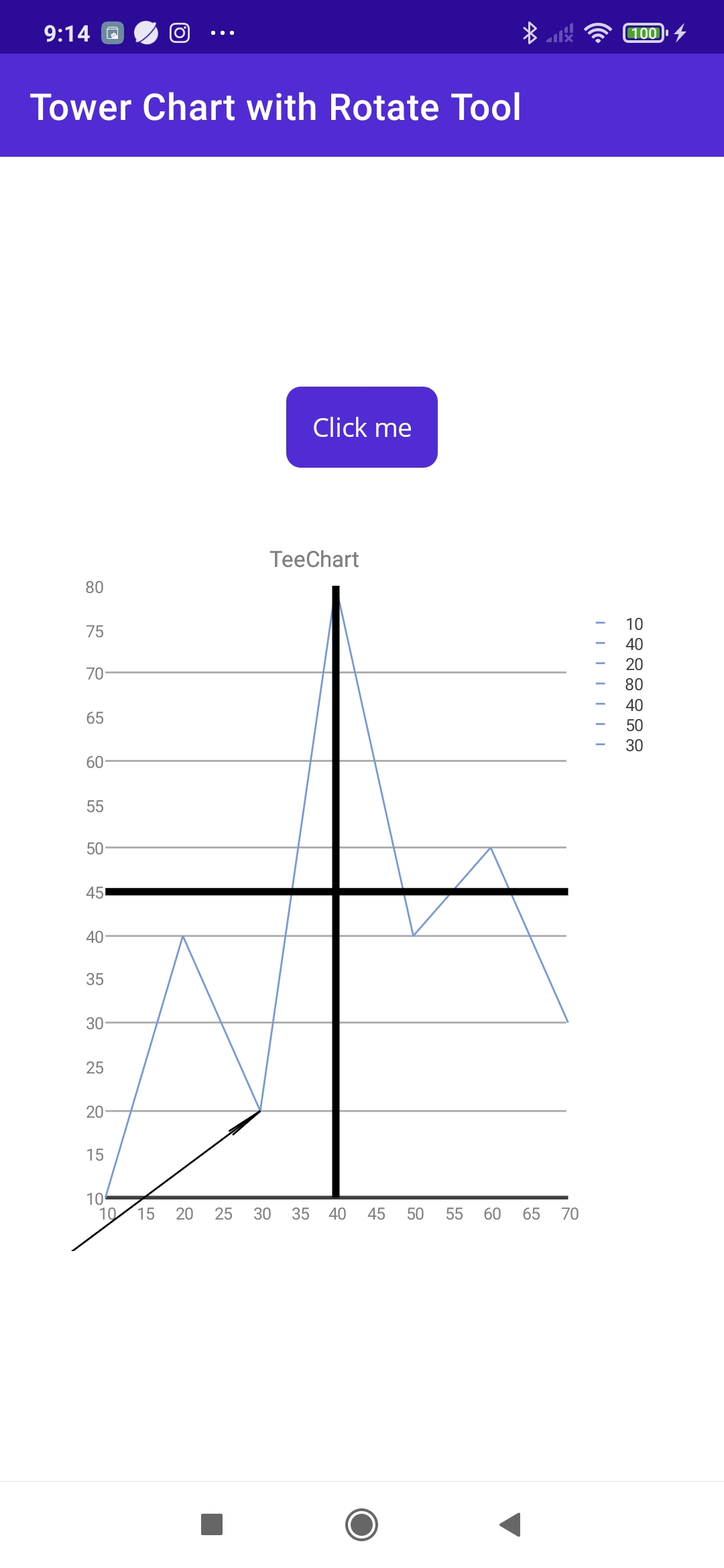

TLC

Post by TLC » Wed Nov 13, 2024 9:23 pm
Not sure how, but got the arrow to show up. but as related to the issue Steema.TeeChart.Tools.NearestPoint Change event doesn't trigger http://support.steema.com/viewtopic.php ... e7a75ee146, it's always at the first point. doesn't change no matter where i click or drag.

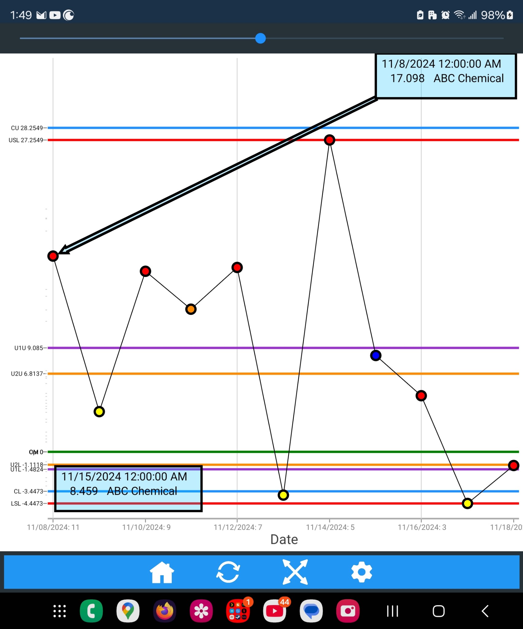

Post by TLC » Tue Nov 19, 2024 8:07 pm
Somehow, the annotation popup hangs around after it is redrawn/invalidated. Only the most recent previous popup is visible aside from the current one. In otherwords, once you click again, it will remove the 2nd oldest, keeping the previous and draws the new one.
The arrow from is the current one, the other is the old one.
