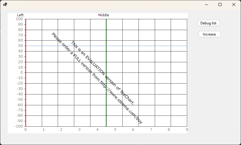

Hey
im creating a few custom y axes and im placing them like this:
(if the image isnt working, the y axes is on the left of the chart)
i need to add titles or some text for every axis, but i want the title to be on top of the axis, what is the simplest way to do that?

A way to achieve this is through the AfterDraw event ( _TChart.AfterDraw += _TChart_AfterDraw; )
I set up an example for you:
        private void _TChart_AfterDraw(object sender, IGraphics3D g)
            // Keep in mind what PositionUnits we're using. I'm choosing Percent, adjust accordingly.
            _YAxis.PositionUnits = PositionUnits.Percent;
            axis1.PositionUnits = PositionUnits.Percent;
            // I prefer storing the text inside the Title property, but make it invisible = false.
            axis1.Title.Visible = false;
            axis1.Title.Text = "Middle";
            _YAxis.Title.Visible = false;
            _YAxis.Title.Text = "Left";
            // Add to a List if we want to use a foreach loop, definitely not needed
            List<Axis> axes = new List<Axis>();
            axes.Add(_YAxis);
            axes.Add(axis1);
            foreach(Axis axis in axes)
                double xPosPercent = axis.RelativePosition;
                double distance;
                if (xPosPercent == 0)
                    // Axis is at the very left of the chart. 30 is just an example that works for this demo.
                    distance = 30;
                    distance = _TChart.Width * (xPosPercent / 100);
                //Finally, place the text with  g.TextOut, which offers different overloads if desired
                g.TextOut((int)distance, 0, axis.Title.Text);
And this is how it would look like:
