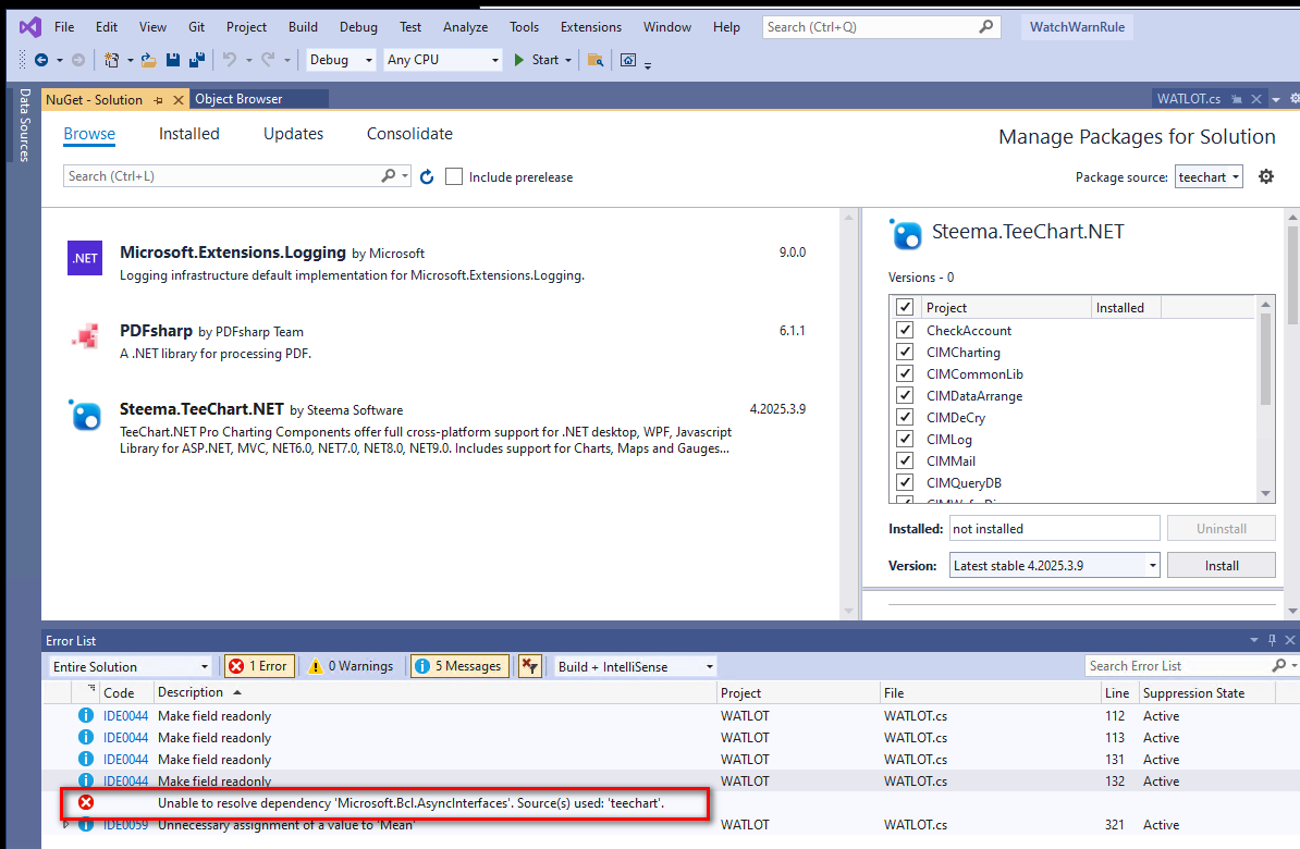

After installing TeeChart, the following picture error message occurs.
We look forward to your professional and warm reply.

I believe the issue comes from upgrading PdfSharp to a newer version. Our package references PdfSharp version 1.5, however, from your screenshot, it looks like you're using the 6.1.1 version instead, which introduces additional dependencies.
As shown here:
PdfSharp on NuGet -- version 6+ requires a dependency for Microsoft.Extensions.Logging, which depends on Microsoft.Bcl.AsyncInterfaces
Could you please downgrade your PdfSharp version to 1.5 and check if the problem is solved?
