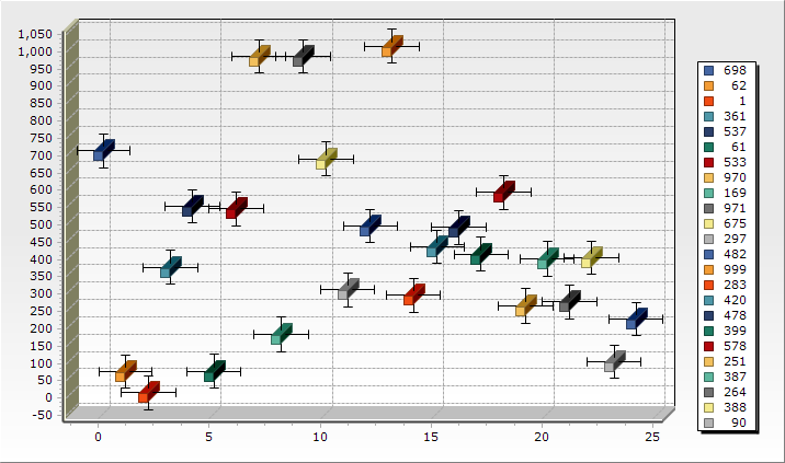

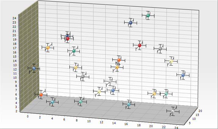

Post by Yeray » Tue Jun 21, 2011 9:43 am
Hello Marcus,
This is just to let you know we've just implemented the ErrorPoint and ErrorPoint3D series. They will be available with the next maintenance release and they look as follows:
