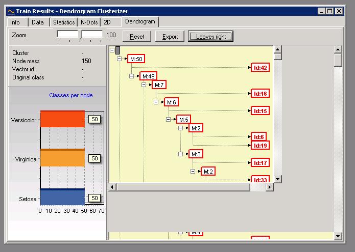

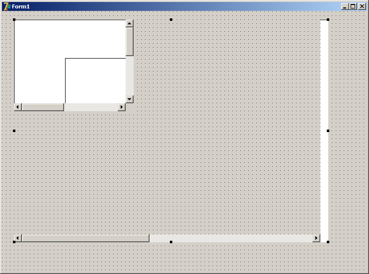

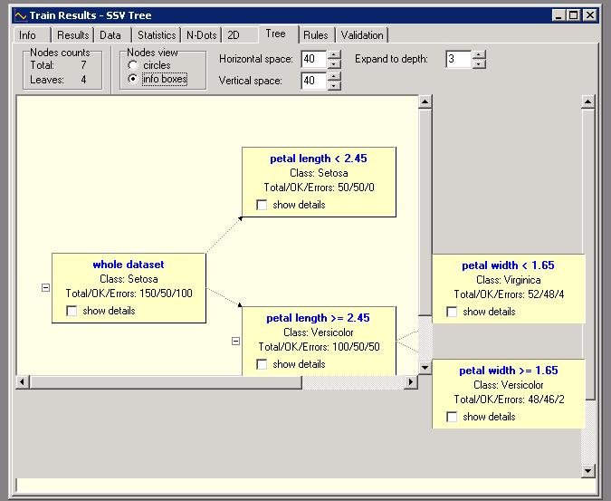

It seems TTree control doesn't get properly refreshed/repainted under some conditions. (see attachments)
It is most noticable after some of tree parameters were changed - first repaint doesn't happen as it should:
a) reposition tree nodes (TTreeNodeShape->X0=...), resize form which contains TTree control
b) change tree node shape, resize form
c) zoom, change tree node shape

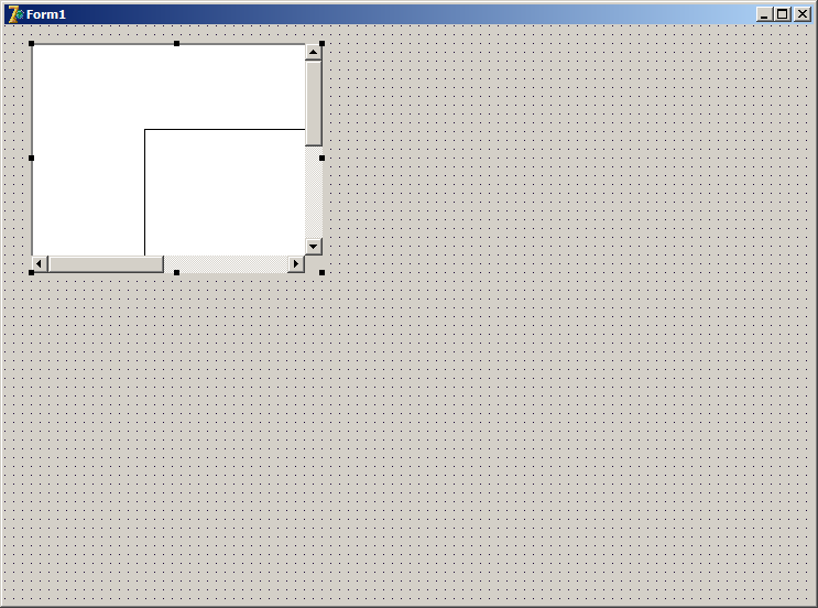

Trying to reproduce it in a as simple example as possible, here is what I get:
1. Create a new application.
2. Drop a TTree in the form, not very big.
3. Double click the Tree to get into the editor. Add a big Rectangle (TTreeNodeShape) and close the editor:
4. Resize the Tree to try to see the whole NodeShape:

So it seems that you were able to easily reproduce it, right ?
The attached screenshot looks corrupted.
