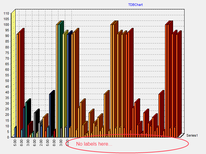

I try to represent few series in MultipleBar = SideAll.
Unfortunatelly I see the problem I've presented on attached screenshot.
What can I do to show labels on axis X for every serie?
I didn't found any info about it here.

There are three (3) series. I've created a Dataset for test purpose and all of these series use the DataSet.
DataSet has fields DateName, Value.
I've configured every Serie to use DateName for Labels, Value for Bar.
Styles for Bottom Axis :
Labels : Visible, Round First, Label on Axis, Angle=90, Style=Auto
All other Values - by default.

Having several bar series, by default, the first series' labels are drawn in the bottom axis. But when you have MultiBar=mbSideAll, certainly it would be nice if all the series' labels could be drawn in the bottom axis without any intervention, so I've added it to the wish list to be implemented in future releases (TV52014973).
In the meanwhile you could use custom labels as follows:
tmpPos:=0;
DBChart.Axes.Bottom.Items.Clear;
for i:=0 to DBChart.SeriesCount-1 do
for j:=0 to DBChart[i].Count-1 do
DBChart.Axes.Bottom.Items.Add(tmpPos,DBChart[i].Labels.Labels[j]);
Inc(tmpPos);

thanks, it works...
