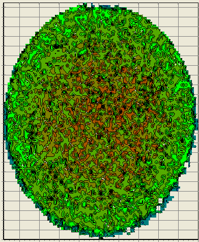

i see the problem yet. Because in our Charts are about 100000 Points i can't make the lines thicker and i can't make the marks visible. And i was wrong, i though the click event is even generated if i click between the contour lines. Our customer wants the values of the of a specific sample chart (see picture) . So it is very hard to point to a single contour line to get the value. We need a event that give us the series value even our customer clicked between two contour lines. Is this possible?
Your sincerely
Willi
Your sincerely
Willi
- test.png (61.98 KiB) Viewed 10087 times

In that case I'm afraid that the TContourSeries.Clicked method can't retrieve if the space between the levels because it is not part of the Series itself.
However, have you tried with a TIsoSurfaceSeries?
