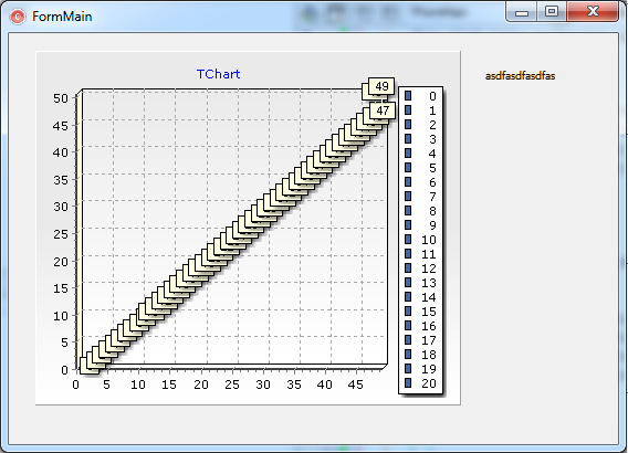

However, it seems to make no difference at all. See attached screen capture. The code seems to be getting into the parts editing the Mark position - but it is like the changes are being ignored. Is there a setting I am missing?
Marks problem

I think the code works fine. It's just it's not as smart as this example needs. Note it checks the marks rectangles with two for loops, but once a mark overlap is detected and a mark is moved to fix that overlapping, the next marks are still going to be checked but not the prior.
Here you have an smarter version:

Thank you, that works for me. Much faster having the chart refresh not in the loop as well.
