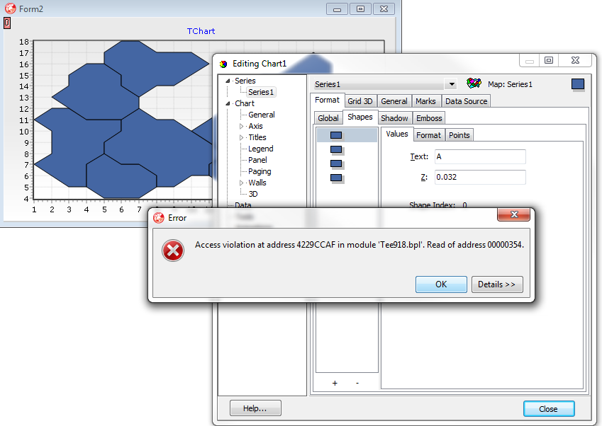

The second issue i found is, that when creating a map series with the editor, trying to access the Shapes Tab in the parent tab "Format" causes access violations - as many as there are polygons, I think.
screenshot with AV
06-09-2013 14-02-29.png (69.99 KiB) Viewed 6745 times

BHinnoForce wrote:The second issue i found is, that when creating a map series with the editor, trying to access the Shapes Tab in the parent tab "Format" causes access violations - as many as there are polygons, I think.
I get a similar error with the same code above and the last TeeChart v2013.08, but not with the actual sources that would be used for the next maintenance release.
