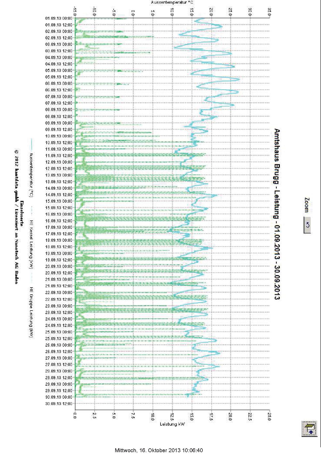

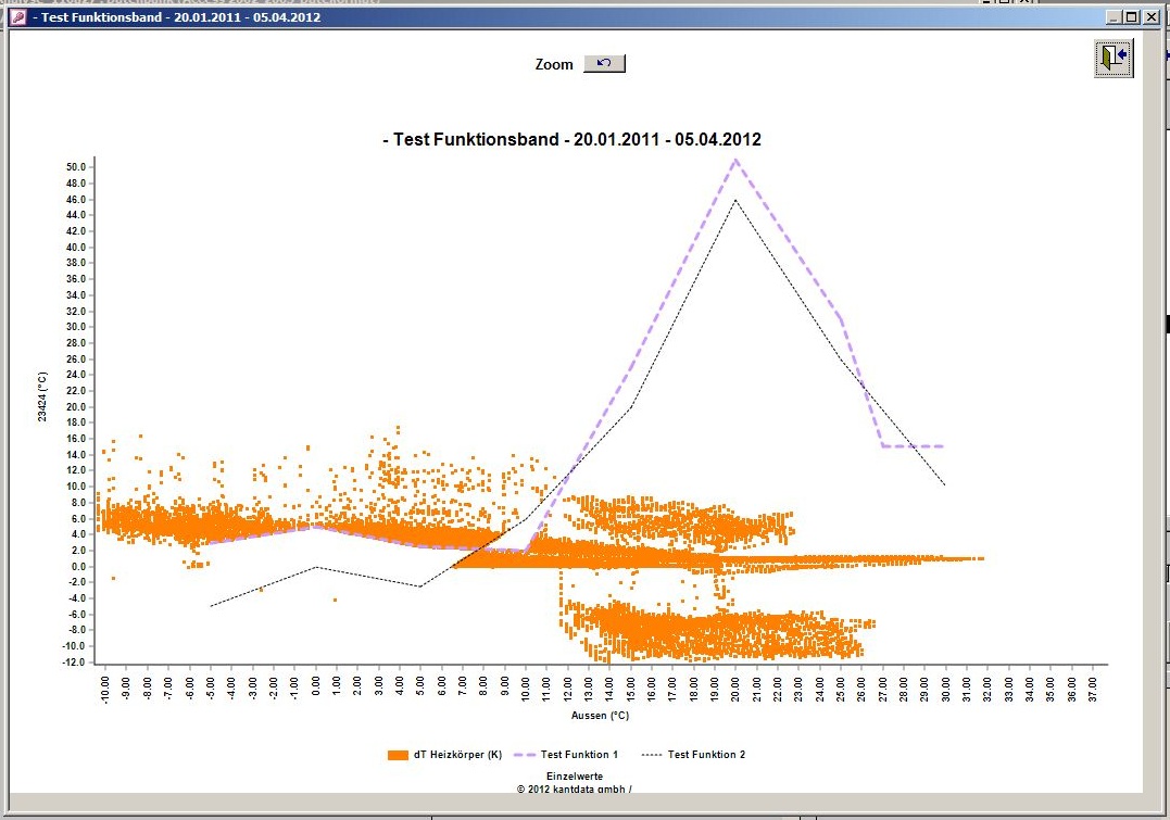

- Screen 2013
- Screen_2013ocx.jpg (349.23 KiB) Viewed 39005 times

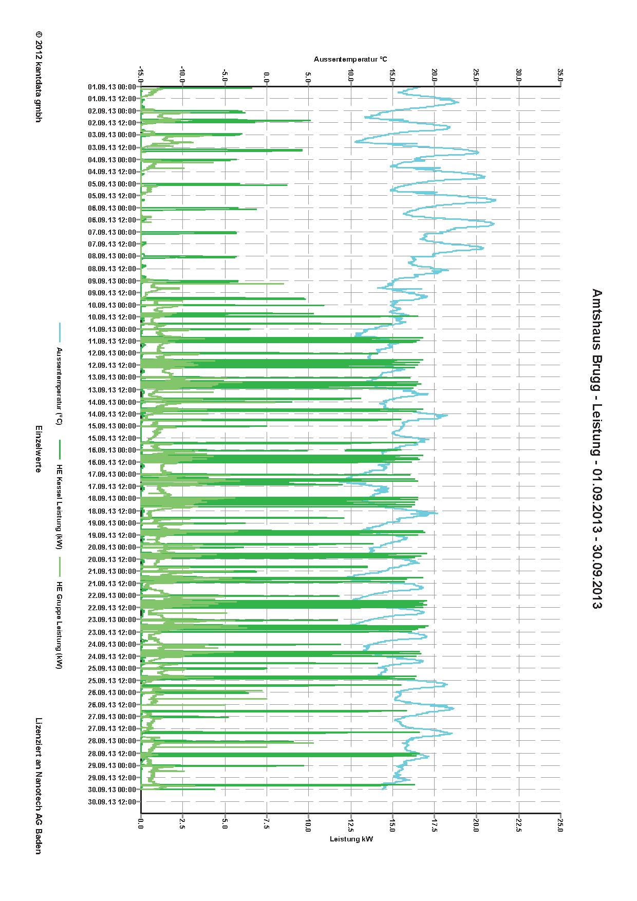

- Print 2012
- Print_2012ocx.jpg (340.3 KiB) Viewed 38953 times

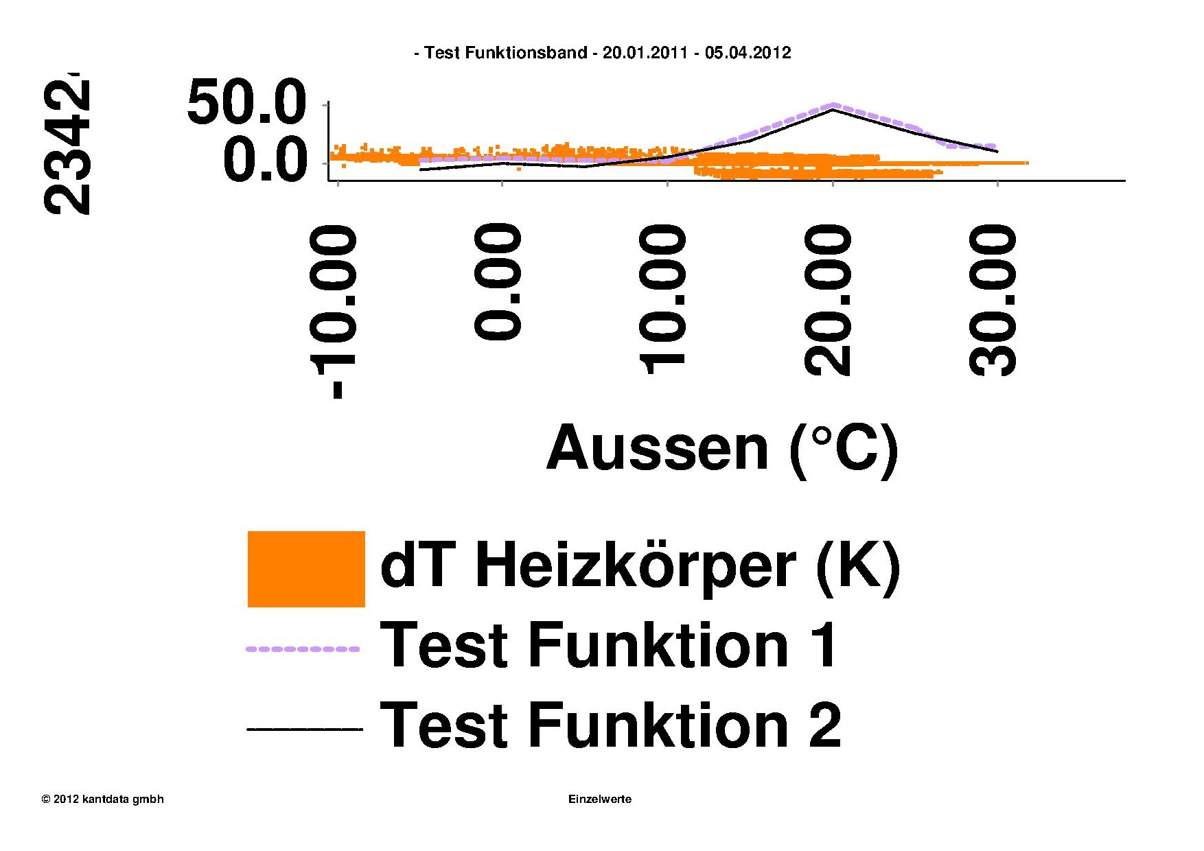

It took me a while to produce the Test database.
It is an Access 2003-DB and has 1 form and 1 report.
Just open them.
The form is always fine unless you want to print it.
Thanks for your help,
Andreas
Just open them.
Andreas

Re: Labels and Titles way too large when printing
Hi Andreas,
Thanks for the example. I can not run it due to missing Codejock.Controls.v15.0.2.ocx. However, the issue most likely is the same as discussed here: http://bugs.teechart.net/show_bug.cgi?id=69. This will be included in the following TeeChart Pro ActiveX maintenance release.

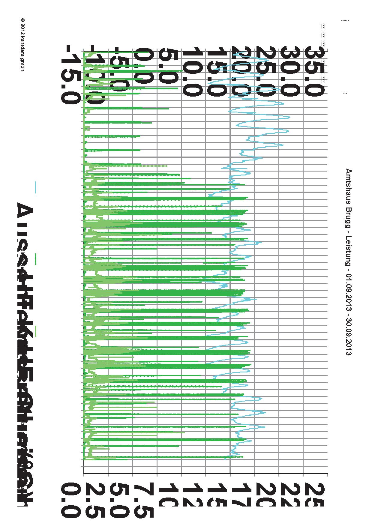

Hi Narcis
Thanks for your test OCX.
We are not quite there yet - see the enclosed JPEG's.
Please note that that title and footer text
are directly on the MS Access form/report,
not on the TeeChart control.
Best wishes,
Andreas
Best wishes,
Andreas
- TeeChart2014_Print.jpg (222.24 KiB) Viewed 38784 times
- TeeChart2014_Screen.jpg (165.02 KiB) Viewed 38800 times
Hi Andreas,
We are investigating the issue here. In the meantime, a workaround is disabling GDI+ in your chart:
TChart1.Aspect.GDIPlus.Active = False
