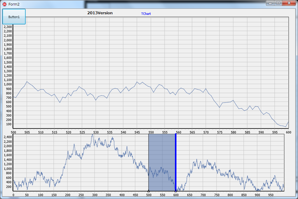

// Bug3
There is no effect even I have changed the property.
But the 2013 version is OK.
See the images I have attached.

// Bug3
I don't understand this part. Could you please explain it with detail?
I don't even see any "Bug3" mentioned in the project you attached
Because the start and end line is invisible by default,
so I had thought that there is no effect even I changed the property of the lines.
It's my fault..sorry!
