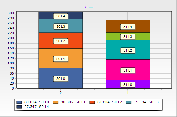

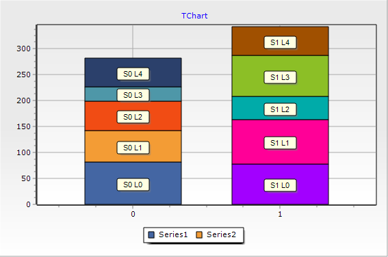

Hi Errol,
However, I'm not sure to understand what's the exact configuration of your chart.
Here is the minimum code to create a chart with two TBarSeries SelfStacked, similar to what I understand you are doing:
However, I don't get a legend like yours. With the default LegendStyle (lsAuto), I get two items in the legend, one per series:
And if I add this to the code above to force the values to be shown in the legend:
Then I get only the values of the first series in the legend:
It would be helpful if you could take the code above and modify the minimum so it can reproduce the situation you are trying to handle here.
As an advance, I can tell you that some customers with problems setting their legends prefer to remove all the series they have from the legend (with ShowInLegend:=false) and then they add as many dummy series (series with no values) as entries they want in the legend. These dummy series are the ones that will be shown in the legend so you may want to change their color, pattern or title.
In general, if you have two series in a chart and you only want one of them to be shown in the legend, you can hide a series with ShowInLegend:=falseErrol wrote:Thanks for your help to date. Now I have a really tricky question. I have created two series, one representing the rock types down a well, and the other an list of unique rock types, sorted alphabetically. Using these, I can display two stacked bar charts (see attachment). I would like to show the first stacked bar chart but display the legend appropriate to the other. I can hide one of the charts easily enough by setting the Y-axis value to 0 for all data points. I have the colors correct for the 2nd series (by using a Legend.Symbol.OnDraw event) but cannot change the text (GetLegendText seems to always gets the text for the first series) and I cannot suppress the extra legend symbols. Ideas welcome.

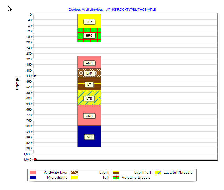

Hi Yeray
Sorry I meant to attach a diagram but forgot, so here it is. I would like to write the text immediately following the legend symbol, rather than having it justified to the right side of the legend text space as at present.

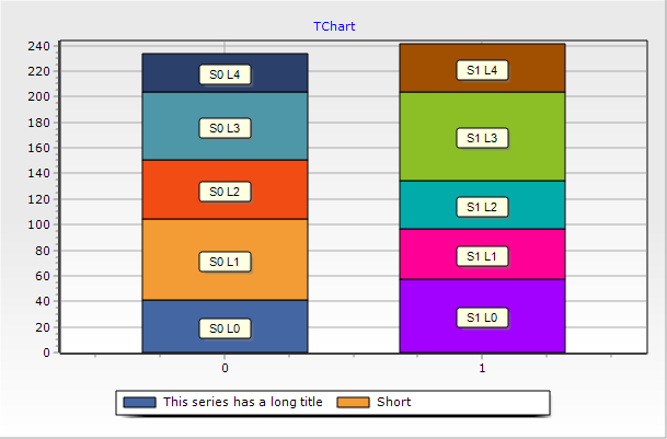

Hello Errol,
I'm trying to reproduce it with the code I posted above, here, adding these two lines of code at the end of the FormCreate method:
And the legend I get shows the legend text left justified:
Please, as I said above,
I understand what you see and what you want to obtain, but I can't reproduce the situation you have.Errol wrote:I would like to write the text immediately following the legend symbol, rather than having it justified to the right side of the legend text space as at present.
Chart1[0].Title:='This series has a long title';
Chart1[1].Title:='Short';Yeray wrote:It would be helpful if you could take the code above and modify the minimum so it can reproduce the situation you are trying to handle here.

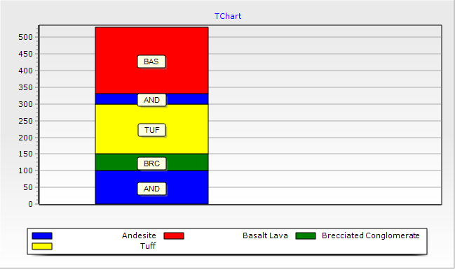

Good morning Yeray
Here is the modified code that exhibits the offset legend. I have put the data record by record into two memory tables to be able to use the DataSource, LabelsSource and similar commands.

Hi Errol,
I've simplified the code you posted to not to use tables and I could reproduce the problem you described above:
However, I see you are adding only one series for the legend, and adding values with labels to this series. Note this is not exactly what I suggested you above:
Here you have an example:
