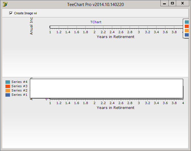

I have a similar problem and found that by simply having OnGetAxisLabel hooked, the chart changes size. The event handler can do nothing at all and the problem will be seen. This project demonstrates the problem. When the "Hook OnGetAxisLabel" checkbox is checked, it will cause the chart to "shrink" vertically.

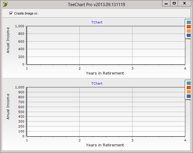

TeeChart Pro 2013.09.131119 does not have this problem -- it works as expected.
This is the correct size without any labels overridden.
Hook OnGetAxisLabel and the resizing appears.
When hooked, changing the labels causes no further "damage".

Then I've checked it with the actual sources we have here and seen it isn't reproducible any more, so I'd expect it to be fixed with the next maintenance release.
I could reproduce the problem with v2014.10 and also see how with v2013.09 the chart height didn't change.tmac2 wrote:TeeChart Pro 2014.10.140220, Delphi XE, Win XP
