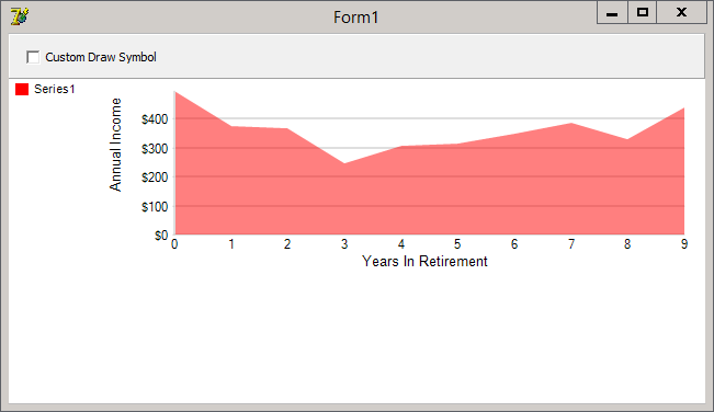

This is what I get with v2014.10:

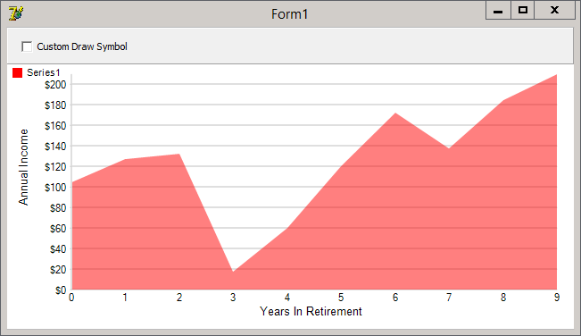

This is what I get with the actual sources (and also with the sources I sent you the 13th March):
Aren't you getting this with the sources from the 13th March?

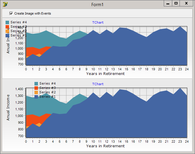

Yes. And there are two images of concern--the chart image and the bitmap created. They are both wrong. Here is a an image--note the legend in the second one.
I'm a bit confused. When I run the project you attached in this post I get the images you can see in the reply to that post. However, the images you just posted seem to be from the project of the beginning of the thread, that we thought were fixed with March 13th sources and the solution Narcís proposed here.
So I'm not sure to understand if the project you attached in this post was to still reproduce the problem of the legend position/size, the transparency in the legend symbol, or both (I reproduced the transparency problem in the symbol legend with the latest sources but not the first one). So I'm not sure to understand what exact problem do you still reproduce with the March 13th sources.
Please, try to summarize the problem you are still reproducing with the latest sources you have so I can get back on track :P

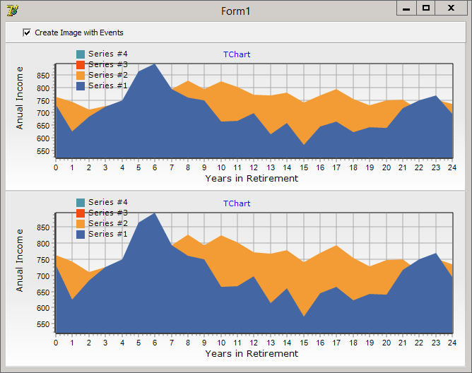

The code that produced the image is attached. I am using the latest source code.

If I run the project as it is with the latest sources, this is what I get:

Then, this is what I get:
Isn't this what you'd like to get?
Isn't this what you get with March 13th sources?
