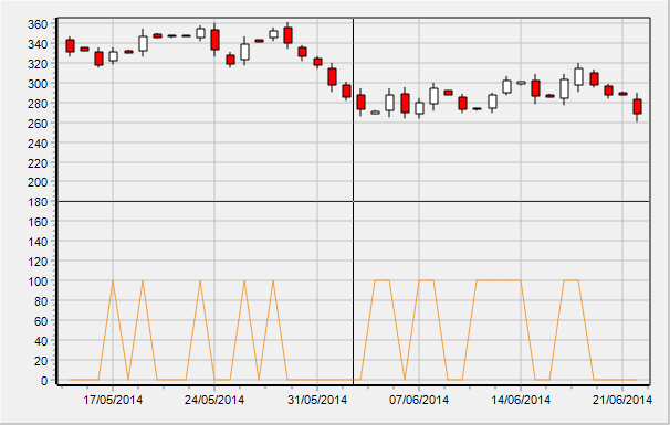

is it possible to add a crosshair not to a series, but to a chart?
Please see the screenshot: It has a crosshair tool added to the candle series.
Its vertical line does not reach the function series, which would be interesting to compare.
See red circle around the "not reaching".
So my question: is it possible to have a crosshair to 2 series or to a chart or to a series including its function?

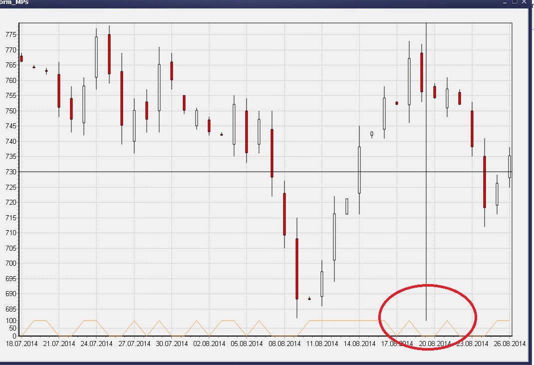

everything default, done in half a minute:
Add a candlestick series, fill it with sample data.
Then add e.g. the RSI function and the cross-hair tool.
You will (probalby) see, that the crosshair will look "short" / not reach the RSI series - as on my screenshot.
This is normal for the tool / functions. At least for me.
For this reason I asked, what I can do as an alternavtive for a vertical line above ALL series.
I use TeeChart Pro v2012/13 VCL version.

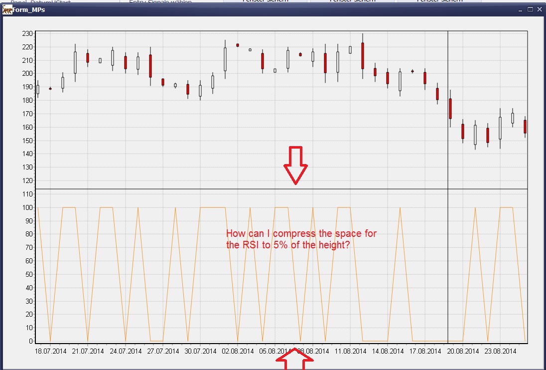

Thank you for your reply.
This is hard, but not impossible with your help. The thing is, that with YOUR code, I cannot do what done with my code (listed above).
So I started a new form and if you allow we try to meet on this base. The project reads this (nothing but your above example fit into my form Form_MPs):

What I cannot do is the scaling. I make you a screenshot to show you WHICH scaling.

In that case you can use a custom axis that occupies 5% of the chart for the RSI function. You'll find several examples at All Features\Welcome!\Functions\Financial in the new features demo, available at TeeChart's program group from the binary version. For example: RSI\Calculating RSI, Momentum Div and CLV (Accum/Distrib) examples. You'll also find more information about axes settings in Tutorial 4. Tutorials are also available at TeeChart's program group.
Finally, you might be interested in associating the cursor tool to the candle series:
So, all of this applied to your code, could be something like this:
Hope this helps!

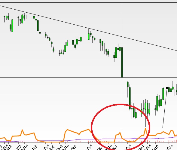

And now we did it. We have a code now, where the original problem occurs (pls. read original posting).
I send you a screenshot. The split of the axis makes it.
What can I do, that the cursor goes down to the bottom?
I do not have only an RSI. I have several extra axis of which it is hard to see exactly which candle they belong to.
If the cursor tool does not do it, I am grateful for any work-around.

Ok, back to your original question:
Yes. However, your custom axis scenario doesn't allow this.is it possible to have a crosshair to 2 series
Yes, not assigning it to a specific series. Again, this doesn't apply for such custom axes charts.or to a chart
Yes, you could add another cursor tool associated to the function series, for example:or to a series including its function?
Chart_MP.Tools.Add(TCursorTool);
(Chart_MP.Tools.Items[1] as TCursorTool).Series:=line1;
Would that fit your needs?
