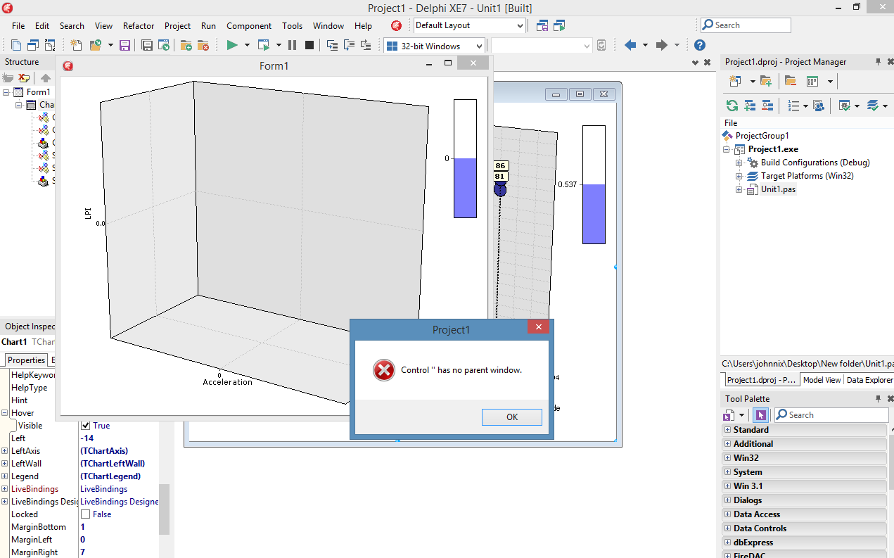

Please find attached a sample project file, when you run it as soon as you hover the mouse over the chart there is an error about control not having a parent. I think it is associated with TLegendPalette. Can you please confirm and suggest a fix?
I am using the latest version of TChart under Delphi XE7.

I open the project file I sent you, run it and move the mouse over the chart and the error appears, we use the same TChart version (mine is 32 bit under Windows 8.1 64 bit).

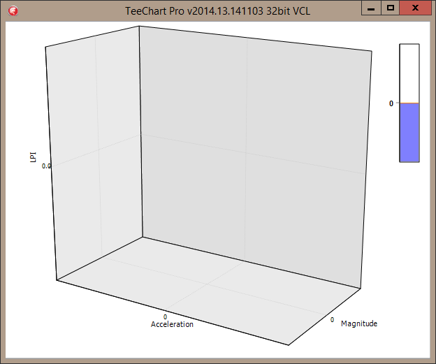

My version is 'TeeChart Pro v2014.12.140923 32bit VCL, you are using 2014.13?

Sorry, I tested it with different versions and made the screenshot with the internal sources we have here

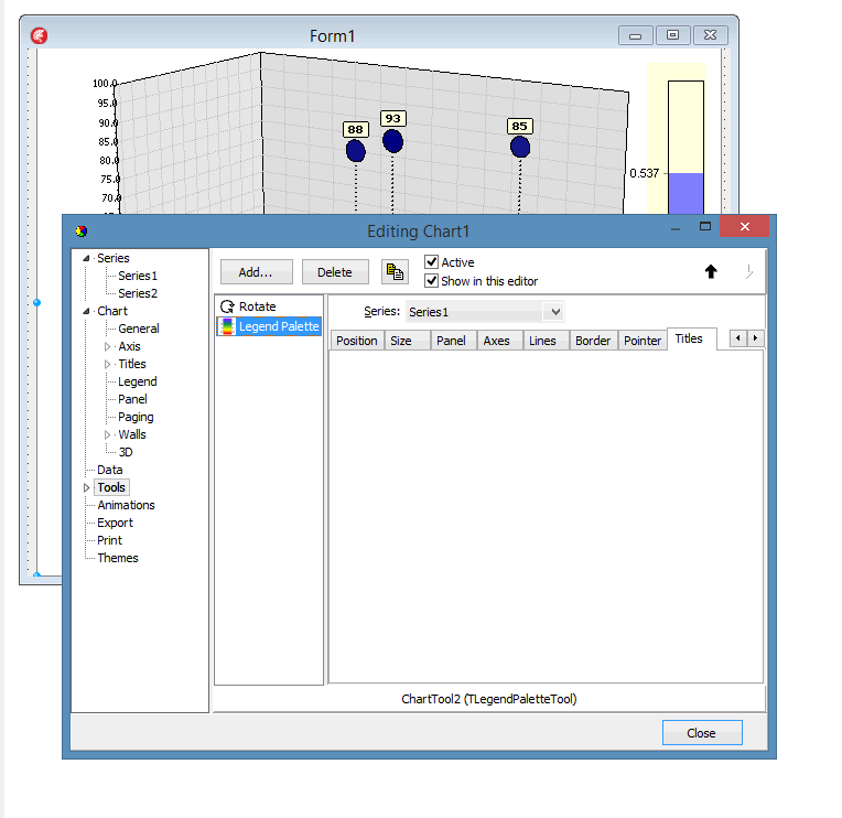

When I try to see the properties of TLegendPalette I get an empty Titles page
- Screenshot 2014-11-11 22.32.gif (29.37 KiB) Viewed 34500 times

#3. Empty titles tab in Legend Palette editor.
I see this happens the first time you open that tab. If you change to another tab and you reopen the Titles tab, then it's shown correctly.
I've added it to the public tracker too:
http://bugs.teechart.net/show_bug.cgi?id=1003

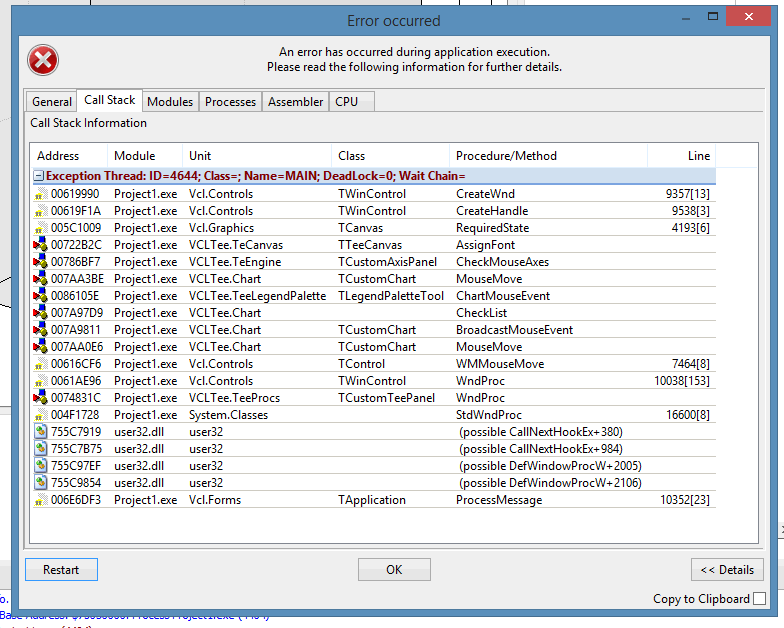

.. here is a screenshot when I enable EurekaLog, if it can be of any help
- Screenshot 2014-11-12 19.58.gif (39.5 KiB) Viewed 34472 times
Re: Bug with TLegendPalette?
Even if we can't reproduce the problem, looking at the Call Stack and debugging the application here I guess disabling Hover should skip the problem you are reproducing. Note TCustomAxisPanel.CheckMouseAxes funcion only does something when Hover is Visible:
I'm afraid we can't suggest much more without being able to reproduce the problem here.
I assume this is referencing the #1 in my last post.johnnix wrote:.. here is a screenshot when I enable EurekaLog, if it can be of any help
