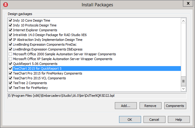

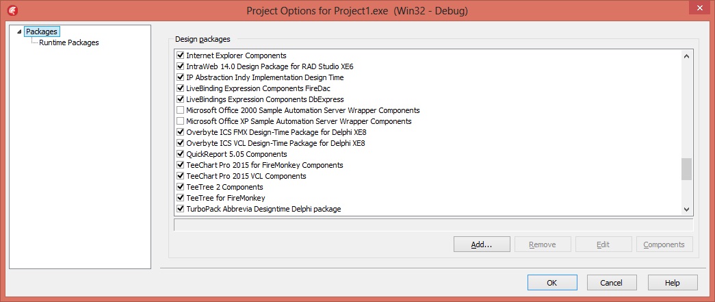

Re: Trying To Install VCL XE8 For QuickReports Pro
I did check that... I haven't done a whole lot with the IDE yet, as I don't have everything installed yet. TeeChart is one of the more important ones I use, so it was one of the first. I have to assume that your installer would have removed the standard version. I have attached a jpeg of what's in mine...
- Components.jpg (107.31 KiB) Viewed 21040 times
I see you are using QuickReport 5.05. Note the latest version of QuickReport is v5.06.
That could be a difference making the packages we compiled here not to work fine in your environment.
If you don't want to upgrade to v5.06 we'd need to recompile the TQRChart packages for that environment, following the instructions here.
However, the error indicated tee*0 (the TeeChart Lite/Std package shipped with the IDE) was still being loaded.
Have you tried to create a new simple example project with just a TChart on the form? If it builds fine, try to output the build version that is being used. Ie:
