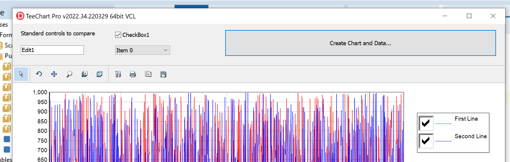

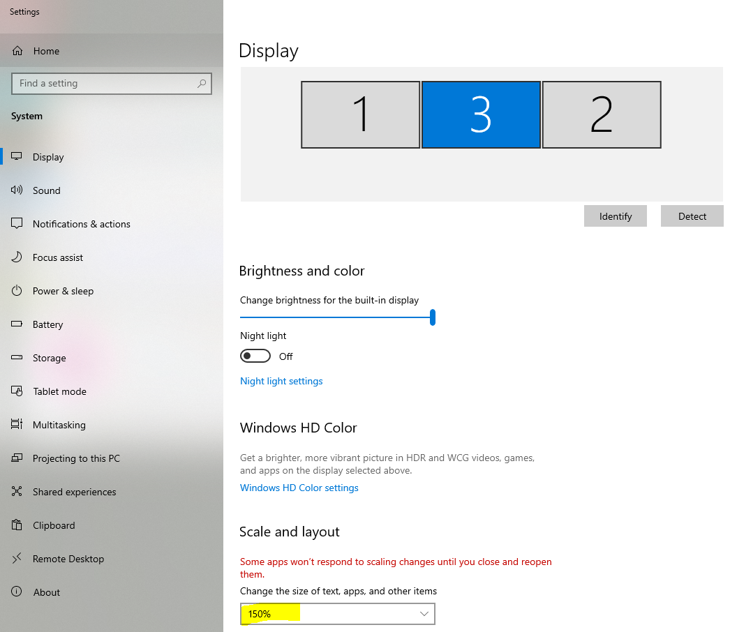

Hello, we recently updated TChart sources from V2021.33 to V2022.35
and we are using Delphi 10.4, compiling for Win 64Bit.
There we noticed that suddenly all the checkboxes to show/hide series
are far too big, as soon as the Display Scaling is bigger than 100%.
The attached screenshot is for a Scaling of 150%:
Partially (for other charts) the Checkboxes get bigger than the whole chart.
Is there a fix available for this bug?

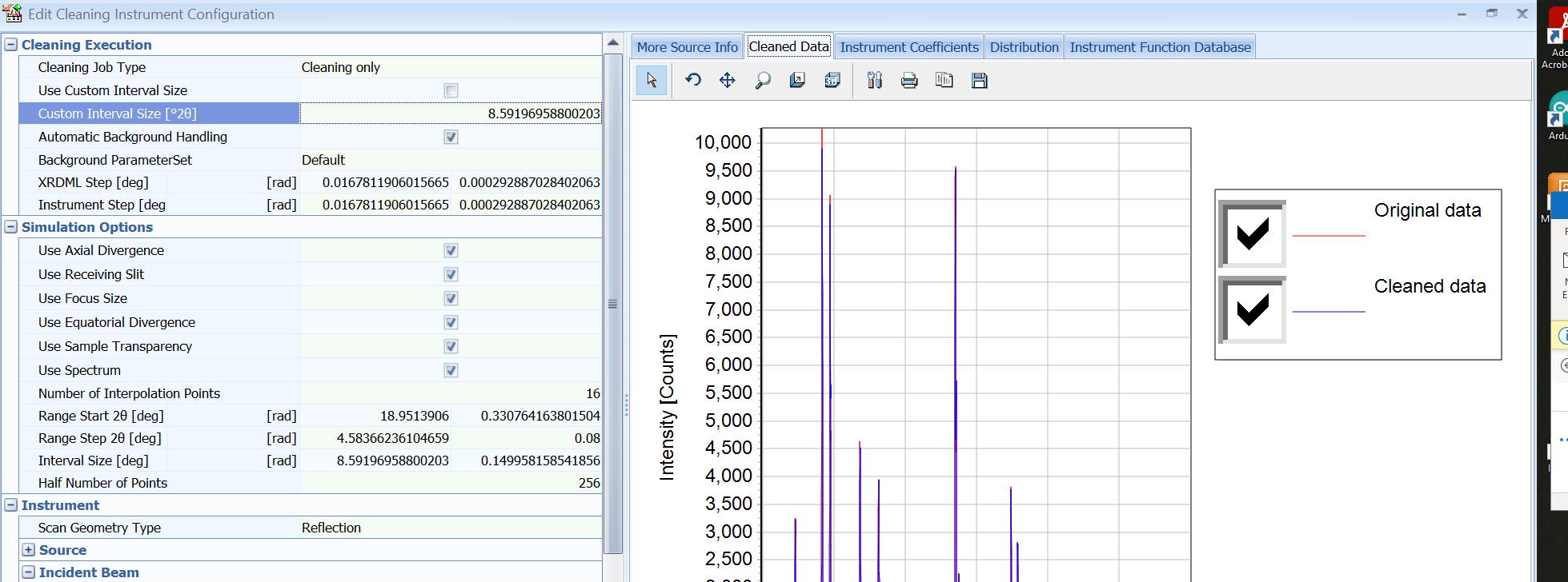

Hello TChart Team,
This is really an annoying bug, with higher display scaling the Checkboxs and with that the legend tends to vanish completely.
Can you reproduce this problem at least, or can I help with that?
Something concerning Checkboxes seems to have changed in the recent release(s) but obviously, this change introduced a buggy behavior. At least with the Delphi version we are using. The current release of TChart is not usable for us.

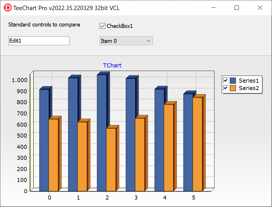

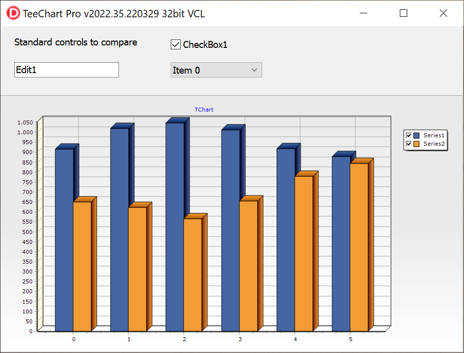

I have two monitors, one at 100% and the other at 175%. I'm running the following test application: Starting the application at the 100% monitor and dragging it to the 175% monitor everything seems to be correctly resized: Starting the application at the 175% monitor, fonts and checkboxes are a bit smaller than the standard components: Could you please check how that test application works for you and modify it to reproduce the problem here if necessary?

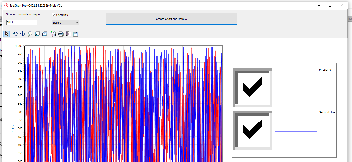

Hello Yeray,
I modified the example, when you press the "Create Chart and data" button (multiple times), just the Checkboxes keep growing. Everything else keeps roughly the correct size.
I also attached the modified project.
