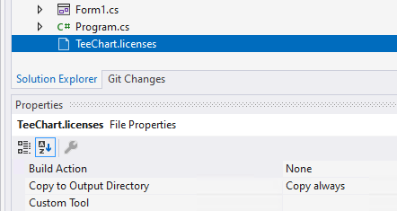

I've just run a test using this specific NuGet:
https://www.nuget.org/packages/Steema.T ... .2023.3.13
Running this in a WinExe project in framework net6.0-windows with the TeeChart.licenses set to Copy always:
Screenshot from 2023-03-17 09-45-20.png (11.2 KiB) Viewed 58896 times
Produces a Chart without a watermark. So we now have to discover what is different about your set up. Which NuGet package are you using? Is your TeeChart.licenses set to 'Copy always' (you could try this in a simple test project to be sure)? Do you have a valid license for TeeChart for .NET 6.0? You can check this latter question by visiting:
