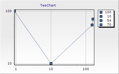

Did you check the influence of data points with x=0 onto charts with logarithmic x axis?
Your data files have points with X=0 and they are plotted correctly in the image I attached, aren't they? Also, using a simpler example (see code snippet below) also plots logarithmic charts with points with X=0 correctly as can be seen here:
            tChart1.Axes.Bottom.Logarithmic = true;
            Steema.TeeChart.Styles.Line line1 = new Steema.TeeChart.Styles.Line(tChart1.Chart);
            line1.Pointer.Visible = true;
            line1.Add(0, 100);
            line1.Add(10, 10);
            line1.Add(150, 54);
            line1.Add(160, 70);;

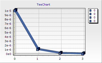

Also, something wrong with X values being zero occurs in this chart. Bottom axis minimum setting is necessary to get something similar to you original chart:
      tChart1.Axes.Bottom.AutomaticMinimum = false;
      tChart1.Axes.Bottom.Minimum = 1e-5;
Which produces this:

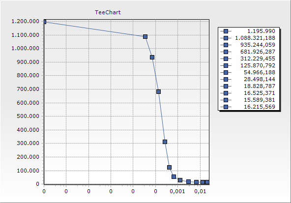

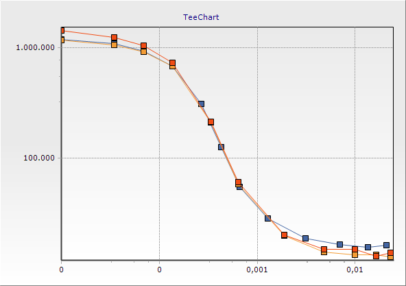

I understood that [TF02015020] is due to the wrong axis labels (LogBottomMin.png). BTW, this problem can temporary be reduced by chosing "", "g" as label format.
But I think that auto scaling should work with logarithmic scales and series having datavalues <= 0 should work, too. So if this is not covered by [TF02015020} I would suggest to make a new entry in your bug list.
And now the good news: Logarithmic axes seem to work with the new assembly, switching between lin/log scale is possible! Calculation of axis values within the mouse move event is correct.
I just started to think that working with TCharts becomes possible as I discovered a new bug, more or less accidently, so here are the bad news:
The next image displays the data of test_1.txt:
Here are the point data:

If you compare these data with the chart then it's obvious that the point with x=0 is drawn at x=axes.bottom.minimum! That's crazy!
And I think its also true for your LogBottomMin.png. It's hard to see since there is a logarithmic y axis but at x=1e-5 should be no point. Please could you provide a fix asap since I urgently need to work with my application!

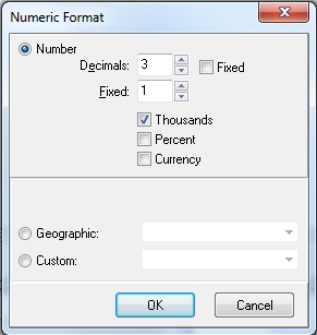

Another thing what I'm wondering about: With axes label format "00e-0" (applied from chart editor) I get axes labels which are wrong for a factor of 10: For instance, instead of "1e-5" the label is displayed as "10e-6". Possibly, this might be intentionally since 10*1e-6=1e-5 but here I do not know anyone thinking so. End user might be confused. So the question is: Is there a possibility to edit the list of default label strings?

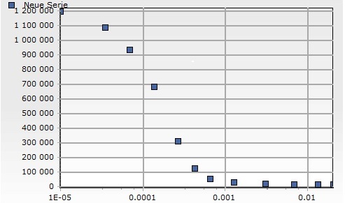

I may not be getting your point here. However, using this code:
      //tChart1.Axes.Left.Logarithmic = true;
      tChart1.Axes.Bottom.Minimum = 0.000000001;
      line1.Add(0, 1195990);
      line1.Add(3.486E-5, 1088321.18811881);
      line1.Add(6.937E-5, 935244.059405941);
      line1.Add(0.0001374, 681926.287128713);
      line1.Add(0.0002696, 312229.455445545);
      line1.Add(0.0004279, 125870.792079208);
      line1.Add(0.0006663, 54966.1881188119);
      line1.Add(0.001289, 28498.1435643564);
      line1.Add(0.003094, 18828.7871287129);
      line1.Add(0.00696, 16525.3712871287);
      line1.Add(0.0135, 15589.3811881188);
      line1.Add(0.02082, 16215.5693069307);
I get this chart:
I don't see anything wrong with it (besides TF02015020). I think it's correct plotting a point at X=0 since one of the data points in the series is added like this:
Is that what you mean? if not, could you please give us more details about the issue?
Yes, you can use GetAxisLabel event for that, for example:
    void tChart1_GetAxisLabel(object sender, Steema.TeeChart.GetAxisLabelEventArgs e)
      if (sender.Equals(tChart1.Axes.Bottom))
        double tmp = Convert.ToDouble(e.LabelText);
        tmp *= 10;
        e.LabelText = tmp.ToString();

Of course, no question. But I must be able to display series (not points) containing data with x<=0 on a logarithmic x axis. In this case, of course, points with with x<=0 must not be displayed. So I will have displayed only the points with x>0. For these points with x>0 autoscaling should work (That's the way my own old Delphi chart component works). So I need nothing to display points with x<0.
No, that's not correct: X axis minimum is not 0. See your own citation above: log(0) is not defined. But the point with x=0 is drawn at
x = tChart1.Axes.Bottom.Minimum (= 0.000000001)
This must not be! Points with x<= 0 can not be displayed with a logarithmic x axis!

No, that's not enough: at design time I do not know what format string is applied by the end user at run time. And even checking the actual label string in tChart1_GetAxisLabel would not help: Inspired by the preset "00e-0" the end user could change it to "000e-0" or "#00e-0" or something else. One can not check for all possible combinations, I think.
Do you think that
"10e-6"
is a correct interpretaion of the number 0.00001 (1e-5)? I don't.

According to MSDN's Custom Numeric Format Strings entry, to get what you request you sould use this ValueFormat set to "0e-0" as in this example:
            line1.Add(1e-5);
            line1.Add(1e-6);
            line1.Add(1e-7);
            line1.Add(1e-8);
            tChart1.Axes.Left.Labels.ValueFormat = "0e-0";
Which produces this chart:

As I understand that: To each series (I work mostly with line, point and fastline) I have to add a handler. Within my application the different kinds of series were created in a lot of different classes (around 20, I think), if required they were copied or converted to another style and so on. Besides the huge amount of work, I expect the possibility to introduce new bugs by myself, performance problems (some series may have 100000 or more points and I have to check it for each pointer, during re-conversion in the else part of the first example I have to determine which pointer is used). And I have already perfomance problems: The implementation of the workaround for bug [TF02014992] requires to paint the chart two times before getting the required apperance (Until now I have not found a better way...). And after STEEMA will have fixed this I have to convert the code back again with the same huge amount of time and bug possibilities...
So I ask you to provide a new assembly with this bug fixed as soon as possible: With this chart behavior I can not start real world use!

This is the VCL editor.
