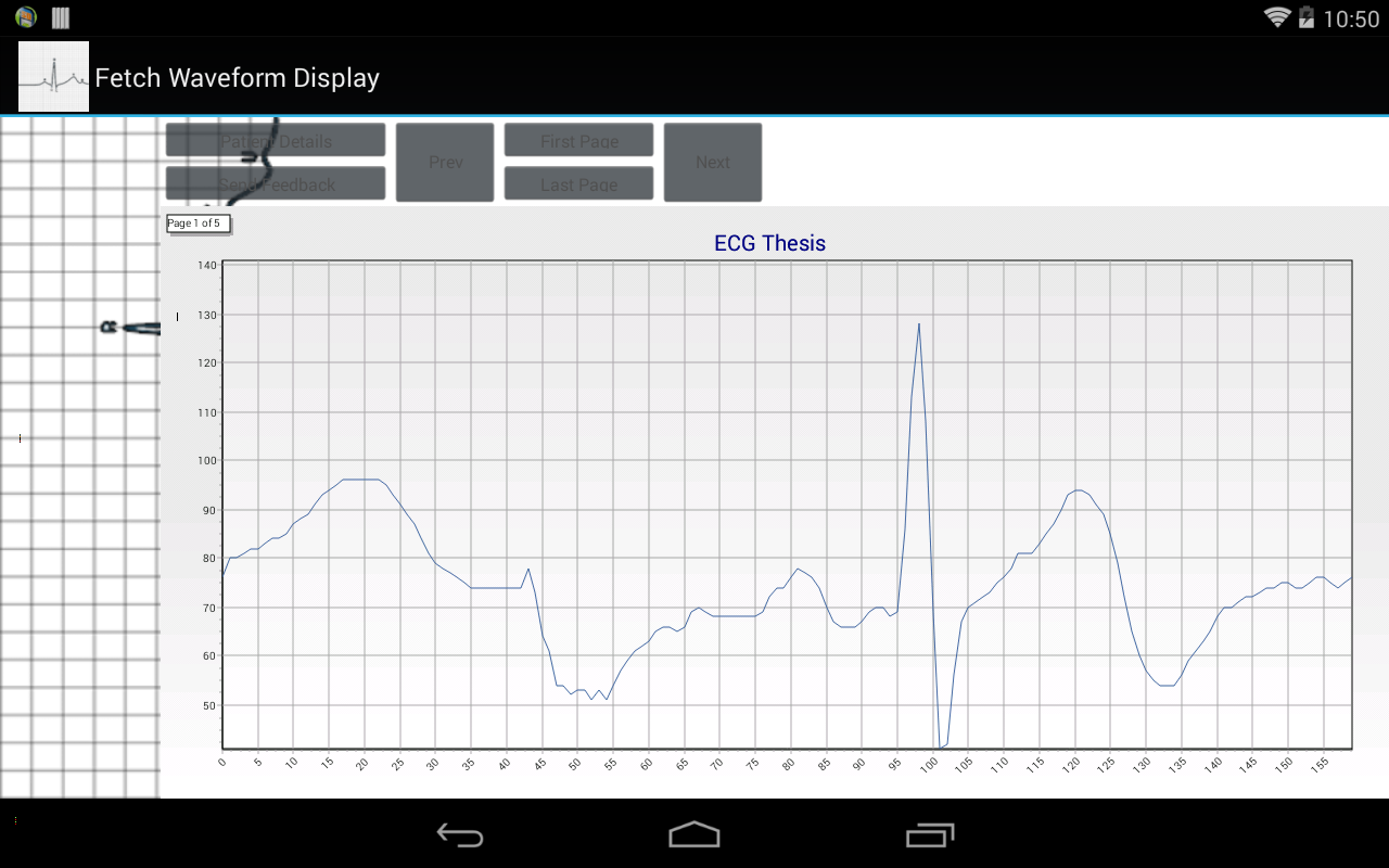

Continuing with this, commenting out the ScrollView related code at FetchWaveformLayout.axml does exactly the same as with the ScrollView on it:
        <!--<ScrollView
            p1:minWidth="25px"
            p1:minHeight="25px"
            p1:layout_width="match_parent"
            p1:layout_height="match_parent"
            p1:id="@+id/scrollView1"
            p1:fillViewport="true">
            <LinearLayout
                p1:orientation="horizontal"
                p1:minWidth="25px"
                p1:minHeight="25px"
                p1:id="@+id/linearLayout3" />
        <!--</ScrollView>-->
This is how it looks like. Notice the layout is not looking very good in a Nexus 7 tablet. Anyway, it was exactly like this with the ScrollView.
Correctly if I'm wrong because I'm still seeing the page numbering in the picture does the graph in the picture actually scrolls?

JAP wrote: Correctly if I'm wrong because I'm still seeing the page numbering in the picture does the graph in the picture actually scrolls?
Yes, it scrolls as per the ZoomStyles.FullChart functionality.
