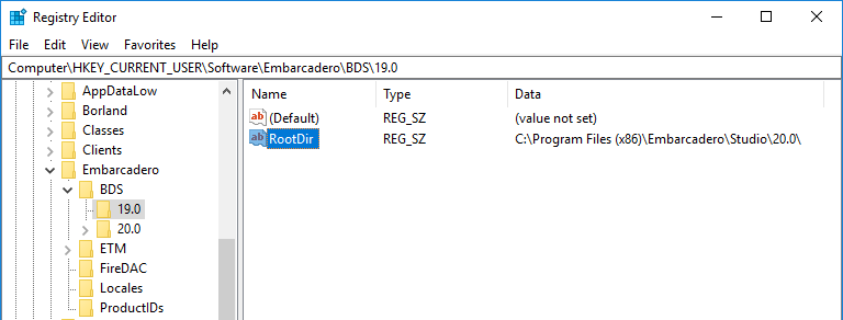

Thanks to all of you (but specially to Aidan), we've been able to reproduce the problem in a new virtual machine with RAD 10.3 Rio installed.
Every time the IDE is launched this key is recreated in the registry: "HKEY_CURRENT_USER\Software\Embarcadero\BDS\19.0"
The problem is RAD Rio is 20.0, while 19.0 was Tokyo. This seems to be confusing TeeRecompile and it probably tries to read some inexisting value.
This means, the new installers will be failing for all those who don't have Tokyo installed in their machines.
We've notified Embarcadero (RSP-22937) and we are trying to fix TeeRecompile.

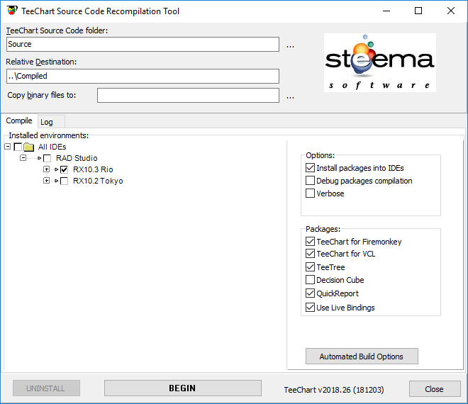

As a workaround, you can create the "RootDir" string value in the "HKEY_CURRENT_USER\Software\Embarcadero\BDS\19.0" key with the data "C:\Program Files (x86)\Embarcadero\Studio\20.0\":
Then TeeRecompile should open and it should list both Tokyo and Rio. Please use only Rio since you don't have Tokyo installed:
Thanks for your patience.
