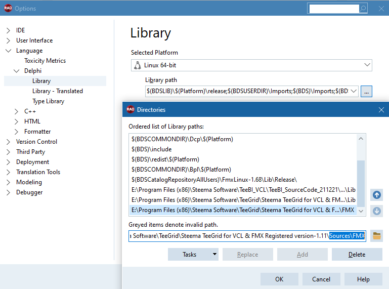

Cannot build linux application using TeeGrid. The folder of "C:\Program Files (x86)\Steema Software\Steema Software TeeGrid for VCL & FMX Registered version-1.11\Complied\Delphi28linux64\lib" does not create any your mentioned FMX* files.
Re: TeeGrid - Delphi 11
Post by Yeray » Fri Dec 24, 2021 8:06 am
The FMX folder should be inside the "Sources" folder. In your case "C:\Program Files (x86)\Steema Software\Steema Software TeeGrid for VCL & FMX Registered version-1.11\Sources\FMX". That's the path to add at the "Library path" for the "Linux 64-bit" platform:
