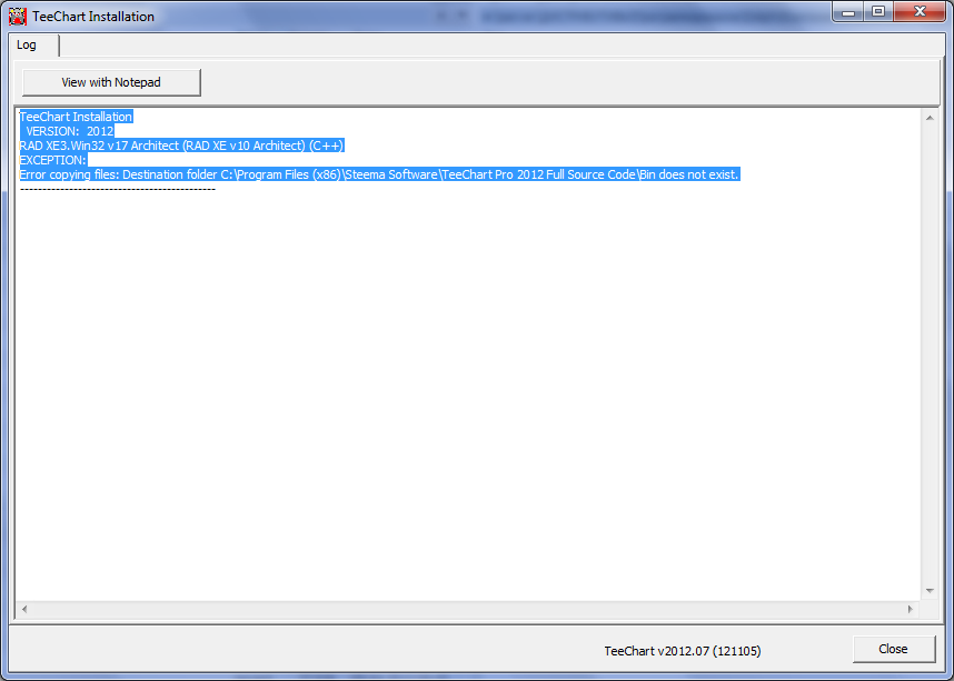

The binary version Build 2012.07.121105 installed successfully. But after installation showed this message:

dfpost wrote:The binary version Build 2012.07.121105 installed successfully. But after installation showed this message:
That's strange.
Anybody else with this problem?
This message is not displayed if you are installing on a computer that is not yet installed TeeChart.

dfpost wrote:This message is not displayed if you are installing on a computer that is not yet installed TeeChart.
I'm not sure to understand you. What should you have installed before installing TeeChart v2012.07 binary on XE3 to get that error? Could you please list the exact instructions we should follow to reproduce the problem here?
  • 1. Install TeeChart2012SourceCode.exe Build 2012.07.121031.
  • 2. Uninstall TeeChart2012SourceCode.exe Build 2012.07.121031.
  • 3. Install TeeChart2012RADXE3.exe Build 2012.07.121105.
Re: Last Installer for XE3 does not work
Post by Narcís » Thu Nov 22, 2012 8:22 am
Hi dfost,
Thanks for your feedback. Could you reproduce it with the 2012.07.121105 build of the source code installer?
