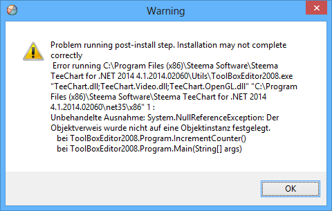

I try to do it !
See the Picture ....
Reinstall will not work ...

Re: webchart zoom error, Line transparency 3d errors, etc.
Post by ikke » Wed Feb 19, 2014 12:29 pm
in reinstalling

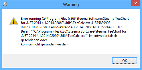

Post by ikke » Thu Feb 20, 2014 2:38 pm
I tried to do this, but an Hreg tool has Errors.
And the ChartEditor is not found in Registry ....
It don't works ...

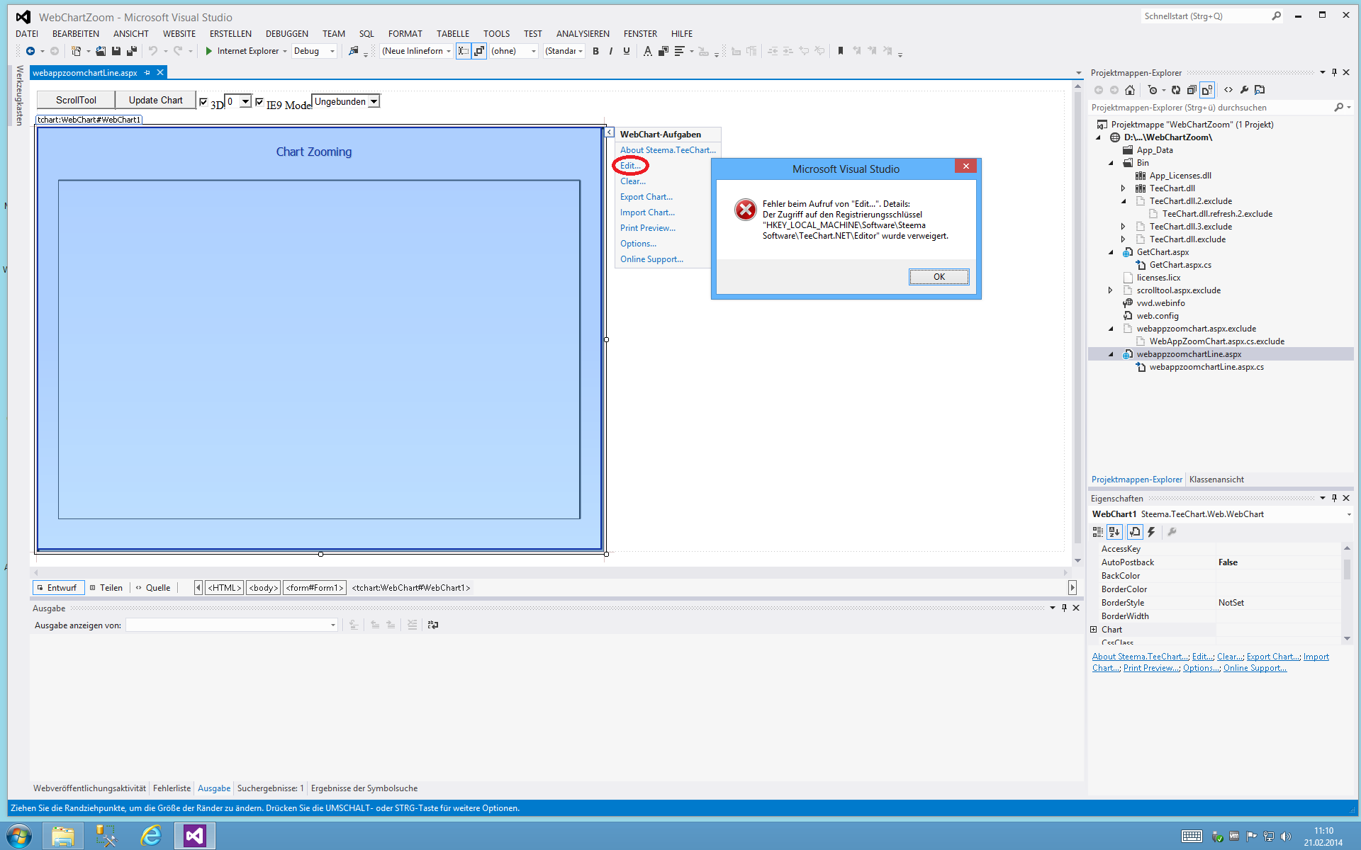

Post by ikke » Fri Feb 21, 2014 10:16 am
We use
We need both Framework 3.5 and 4.5 for VS2012 ( 'Windows 8' ) !
Error ..
Post by Christopher » Fri Feb 21, 2014 10:23 am
ikke wrote:We use
Error ..
Does this error occur if you run the VS2012 as "run as Administrator"?
If the error doesn't occur when you run the VS2012 IDE as "run as Administrator", then please do so for now. This is a known issue in the binaries you have and has already been fixed; the fix will become available in a new maintenance release due out within the next two or three working days.
Post by ikke » Fri Feb 21, 2014 10:32 am
No
I hope...
Can i hope ?
