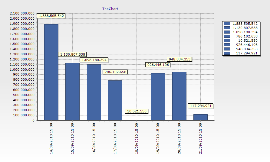

Ok, I think I've got a workaround now for the problem where labels don't align correctly with the bars, thanks.
I know you say this is by design but I really think you need to reconsider that design.
A bar graph by any definition I can find is primarilly used to show discrete values, and therefore the labels of those discrete values should align correctly with the bars. The example I've posted previously,
13-08-2010 9-13-27 AM.png (4.25 KiB) Viewed 104697 times
shows the left most bar with a label of 27/12/1999 when the data for that bar is 26/12/1999. To assume that the end user of this chart should know that because the label is ever so slightly to the right of the center of the bar they should extrapolate the dates to arrive at 26/12/1999 is quite ridiculous and forces the publication of charts that are plainly wrong.

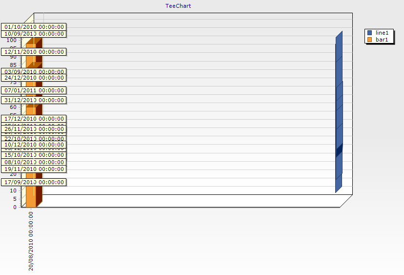

Upon further investigation it seems that this workaround wont really work.
The problem comes when we want to overlay our bar chart with a line graph using a line such as line.Add(dte, y), which is how we are currently creating line series charts. We then rely on interval and axes label formats to apply formatting etc. We end up with a chart like
This I'm assumiong is because the bar charts xvalues aren't set. I've tried all of the Bar.Add methods in an attempt to set the xvalues but in all cases when Xvalues are set the chart looses labels when the window is resized.
My only alternative is to change the way I create live graphs to add the data in the same way you suggest to add bar data but this is not going to work because my users want to use the increment feature.

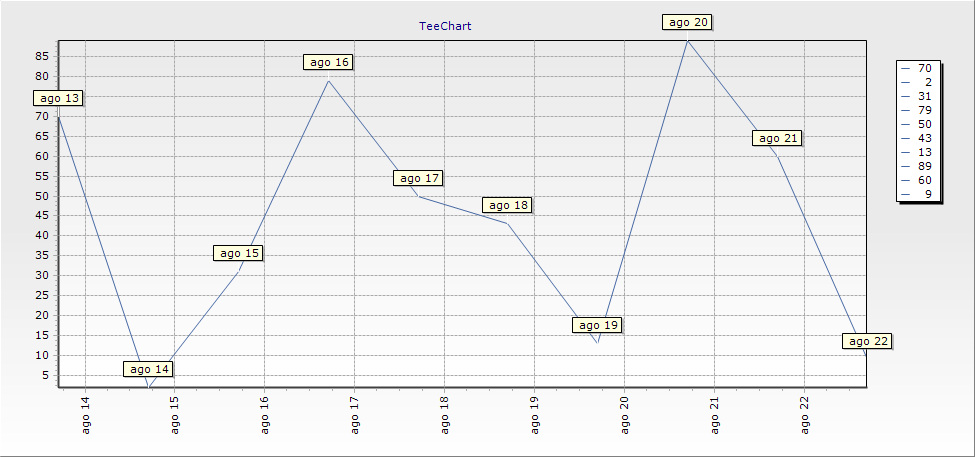

I can see the same behaviour we described with Line series. Adding the points with datetime and without labels, the labels aren't aligned:
            Steema.TeeChart.Styles.Line line1 = new Steema.TeeChart.Styles.Line(tChart1.Chart);
            line1.Marks.Style = Steema.TeeChart.Styles.MarksStyles.XValue;
            line1.Marks.Visible = true;
            tChart1.Axes.Bottom.Labels.DateTimeFormat = "MMM dd";
            tChart1.Axes.Bottom.Increment = Steema.TeeChart.Utils.GetDateTimeStep(Steema.TeeChart.DateTimeSteps.OneDay);
            Random rnd = new Random();
            DateTime date = DateTime.Now;
            for (var i = 0; i < 10; i++)
                line1.Add(date.AddDays(i), rnd.Next(100));
            line1.XValues.DateTime = true;
Captell wrote:Upon further investigation it seems that this workaround wont really work.
You are adding the bar series values without XValue. This makes the XValues to be 0, 1, 2,... And you are adding the line series values with XValues, DateTime XValues that would probably be around nowadays so they have values about 40000 approximately. So I'm afraid it would be an expected behaviour because your bar series XValues and your line series XValues are very far.

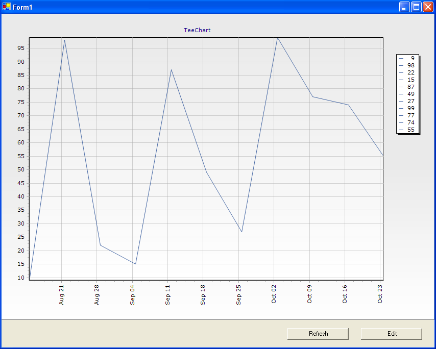

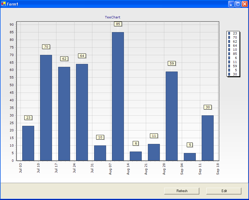

I just tried something from your statement
The following code correctly aligns the labels, the dates are added to the chart as DOUBLE, all chart properties functionality works correctly, i.e. label formats, increments etc. resizing the window has no detrimental effect... so here all is well.

Yet the following doesn't, same as previous chart and example except using a bar series, so here is evidence that there is something different between bar and line.

going back to the line example, if you change it to add the X value as a date it doesn't correctly align, so here is evidence that there is something wrong with the way labels are aligned when they are added as date time.

Captell wrote:The following code correctly aligns the labels, the dates are added to the chart as DOUBLE, all chart properties functionality works correctly, i.e. label formats, increments etc. resizing the window has no detrimental effect... so here all is well.
Captell wrote:Yet the following doesn't, same as previous chart and example except using a bar series, so here is evidence that there is something different between bar and line.
The explanation is that a point in the Bar series is quite wider than the Line series points. Try the following in your firs example:
line1.Pointer.Visible = true;
line1.Pointer.HorizSize = 30
Or the following in the second:
bar1.CustomBarWidth = 50

While we study the convenience of this new property, you may be interested in trying another possibility:
            bar1.Marks.Style = Steema.TeeChart.Styles.MarksStyles.XValue;
            tChart1.Axes.Bottom.Labels.Style = Steema.TeeChart.AxisLabelStyle.Mark;
                bar1.Add(date.AddDays(i), rnd.Next(100));
            bar1.XValues.DateTime = true;
Using MarksStyles.XValue and AxisLabelStyle.Mark aligns the axis labels with the bars but, of course forces you to show the same in the points marks and in the axis labels (or to hide the points marks).

We've added a new AxisLabelStyle, named PointValue meaning mandatory ValueList value displaying on the axis which is associated with the notMandatory ValueList (notMandatory is XValues in Bar or Points Series and is associated with Bottom Axis by default).
So the following can be done (also through the editor):
        private Steema.TeeChart.Styles.Bar series;
            series = new Steema.TeeChart.Styles.Bar(tChart1.Chart);
            series.XValues.DateTime = true;
            DateTime date = DateTime.Parse("14/09/2010 15:00");
            for (int i = 0; i < 8; i++)
                series.Add(date.AddDays(i), rnd.Next());
            tChart1.Axes.Bottom.Labels.DateTimeFormat = "dd/MM/yyyy HH:mm";
            tChart1.Axes.Bottom.Labels.Style = Steema.TeeChart.AxisLabelStyle.PointValue;

Ok, this is just as easy as:
            _testChart.Clear();
            var bar = new Bar(_testChart.Chart);
            _testChart.Axes.Bottom.Labels.Angle = 90;
            _testChart.Axes.Bottom.Labels.Separation = 1;
            _testChart.Axes.Bottom.Increment = 0;
            _testChart.Axes.Bottom.Automatic = true;
            for (var i = 0; i <= 10; i++)
                bar.Add(DateTime.Now.AddYears(i), i);
Now when you show this chart on your form, bring your chart editor and just change the bottom axis increment to your predefined option "One Year". Now I expect to see the current month in the labels - but some other month is shown. You can change the code to add months instead of the years, change increment to be "One Month" and try to see the current date being in your labels. It never works for me... ever
