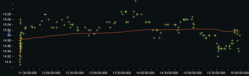

Axes labels questions
Post by gs » Fri Jul 17, 2009 10:08 pm
I have 2 questions about axes labels
1) Displaying Datetime labels on bottom axes when time range is in millisecs.
settings for axes
chart.Axes.Bottom.Labels.DateTimeFormat = "HH:mm:ss:fff";
chart.Axes.Bottom.Increment = (double)DateTimeSteps.OneMillisecond;
The datetime are not displayed in this scenario. It is displayed when time range is in secs or more. I am attaching the screenshots

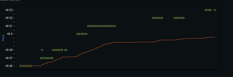

2) second question. On Y axes I want to display axis labels at the points only on the series & not equal division of the axess. I tried doing this by handling getaxes label. As seen in the image this avoids displaying labels on axes but blank ticks are still visible.

Re: Legend Checkbox
Post by Sandra » Mon Jul 20, 2009 8:53 am
Hello Sachin,
When you want to increment values in axes with DatetimeFormat, you must use next lines of code, why works fine. Because this chart.Axes.Bottom.Increment = (double)DateTimeSteps.OneMillisecond, isn't correct.
            tChart1.Axes.Bottom.Labels.DateTimeFormat = "hh:mm:ss:ff";
            tChart1.Axes.Bottom.Increment = Steema.TeeChart.Utils.GetDateTimeStep(Steema.TeeChart.DateTimeSteps.OneMillisecond);
If you want to hide Ticks, and minorTick, of your chart only you do next lines of code for your custom axes:
           axes.Ticks.Visible = false;
           axes.MinorTicks.Visible = false;
I hope that will helps.
Basically what I was looking was, I needed axis to be labelled at all the YValues which corresponds to the series points and not equal division provide by TChart.
for eg. my series is drawn over ponts (10.0, 10.1, 10.5) Yvalues I needed this values to be labels on axes and not (10.0, 10.2, 10.4, 10.6) provided bu chart.
Sachin
Re: Legend Checkbox
Post by Sandra » Thu Jul 23, 2009 9:28 am
Hello gs,
I'm sorry, I think that next is that if you want to do, please see next code and check that works with you want in your application.
