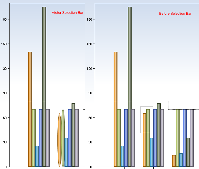

Chris.CHWU
Posts: 57
Joined: Wed Jan 30, 2008 12:00 am
Re: Selection of bar from bar chart
Post by Chris.CHWU » Mon Aug 03, 2009 11:44 am
Thanks your advise!!
But i have a problem about event~
I am trying mouse up and mouse down event to handle the bar chart selection, but i can'tchange the bar color (only bar styles). How can i modify it that changebar color ?!

Chris.CHWU
Posts: 57
Post by Chris.CHWU » Tue Aug 04, 2009 1:41 am
I try the example is ok, thanks!
I still have some problems.
1. How to cancel the series click color? if i don't want highlight the bar.
2. I want to select certain bar by draging a rectangle region, and highlight the bar. (after selection).Then i could set the bar color.
I tried MouseDown and MouseUp to selection the bar and redraw the chart, the event of "Steema.TeeChart.Styles.GetPointerStyleEventArgs" i just get the style attribute.
How can i change the bar color?
