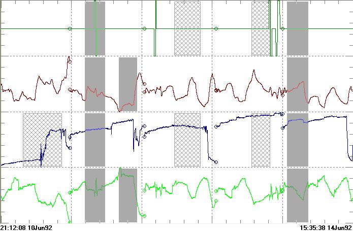

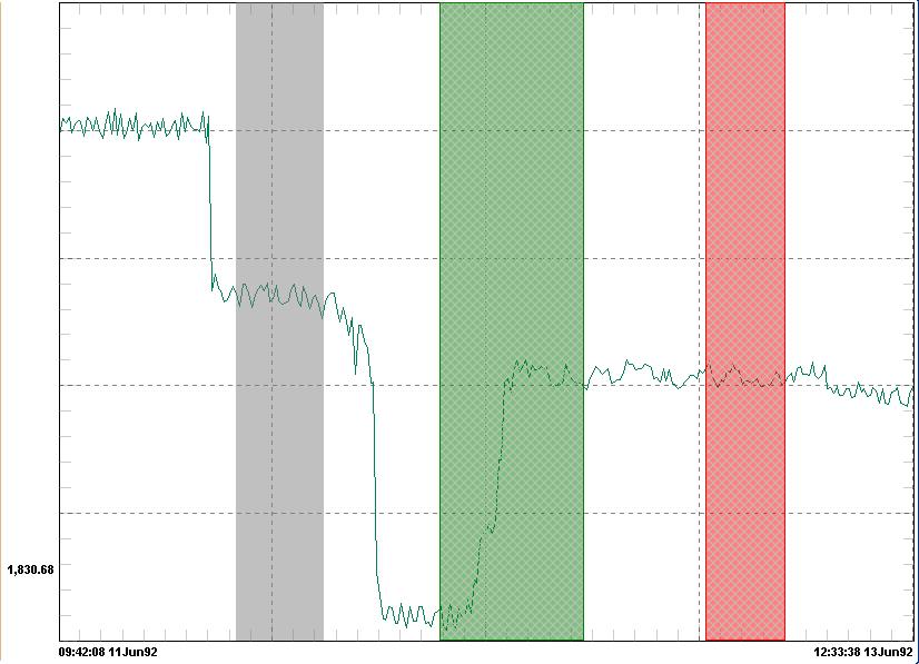

Please let me know if i can specify the left, width, top and height of the ColorBand tool.
Please have a look at the screenshot below from our own product that has been developed using MFC-
Now let me know if it is possible to use the ColorBand tool to do these kind of highlightings in TeeChart control.
I think ColorBand tool is always associates with a axis. It is really a disadvantage of the usage of the tool.
For the markings shown in the screen shot i have to specify the left, width, top and height for the tool.
Please let me know if you have any alternative solutions for this problem.
Also please allow the users to specify the left, width,top and height of the ColorBand tool. It is really required.
