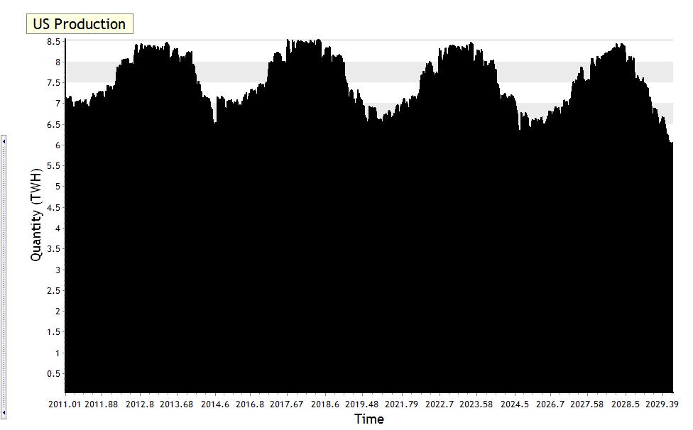

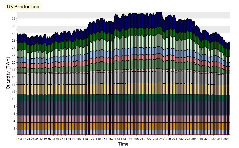

When there are many x-axis values in our chart, it appears as all black. I think it is because of the lines that run vertically on the chart.
The screenshot attachments explain it better. In the first screenshot, there are 10800 x-axis values which means 10800 lines, so it's a black blob. In the second screenshot which has 360 x-axis values, you can see the individual black lines that I think are causing the problem. I think I just need to know which property toggles those lines on and off.
The chart is fine when it is converted to a line chart because it does not have these lines. We are using TChart v7.12, in Delphi 2007. Many thanks for any help.

Post by Yeray » Mon Mar 01, 2010 8:46 am
Hi Doug,
Try these properties:
  Series1.Pen.Visible:=false;  //bar series' vertical lines / area series' top tines
  Series1.AreaLinesPen.Visible:=false;  //area series' vertical lines

Post by Doug » Mon Mar 01, 2010 7:36 pm
AreaSeries.AreaLinesPen.Visible := false;
Sorted it! Thanks a million.
