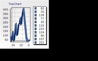

Using TeeChart for .NET 2009 I get this:

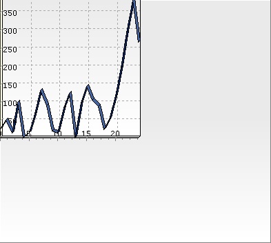

While using TeeChart Pro 2010 VCL beta I get this:
Which is what I'd expect from CustomChartRect.
