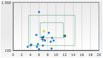

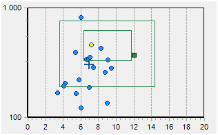

In the attachment there are two TChart with logarithmic scale and the same data. First is WPF TChart (ver. 4.0.2010.13053), second WinForms TChart (ver. 2.0.2987.19069).
You can see: pictures are quite different! Why??

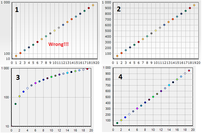

Hi Yeray!
Logarithmic scale bug is very serious!
I have changed your sample a little to see points from 10 to 1000.
Please see attached pictures
Picture N 1 (WPF TChart Version=4.0.2010.27963, logarithmic scale) is wrong! It's look like Picture N 2 (WPF TChart Version=4.0.2010.27963, linear scale).
Picture N 1 must be look like as Picture 3 (Windows Forms TChart Version=2.0.2987.19069, logarithmic scale)! Picture 4 (Windows Forms TChart Version=2.0.2987.19069, linear scale) is here only to compare with others.
Please fix this bug, it's very serious, because of it we have to use old TChart versions and can't go to using WPF TChart!!

Post by Yeray » Wed Jun 30, 2010 6:47 am
Hi neurosoft,
We haven't forgotten this. We are investigating it and we'll be back here asap.
Posts: 9676
Re: Logarithmic scale bug
Post by Yeray » Wed Jun 30, 2010 11:59 am
Hi neurosoft,
We've found the problem and solved it. The fix will be available with the next maintenance release.
In the meanwhile here it is an ugly workaround:
After: tChart1.Axes.Left.Logarithmic = true;
Run: tChart1.Axes.Left.Horizontal = tChart1.Axes.Left.Horizontal;

Post by neurosoft » Fri Jul 02, 2010 9:44 am
Hi Yeray!
It works! Thank you!!
