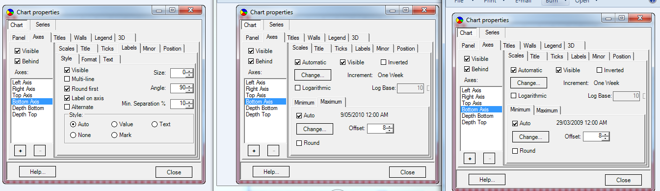

I have a chart that is plotting weekly summary data using a bar graph but I can'y get the x axis labels to line up properly. The data starts 29 Mar 2009 and ends 9 May 2010 in weekly increments, if I plot this data using a bar series I can the following.
21-05-2010 6-27-43 AM.png (12.83 KiB) Viewed 144132 times
As you can see the first label is 01 April 09, what I need is for the bar to have the correct label of 29 Mar 09 and for the label to be centered under the bar.
I've tried several different axis options but no matter what I try I can't get the labels to line up properly, If I increase the size of the chart (see next image) the labels change but still do not line up properly with the bars. Am I missing something here or is this a bug?
21-05-2010 6-33-20 AM.png (6.73 KiB) Viewed 144137 times
Here are sone screen shots of relevant properties pages
21-05-2010 6-42-11 AM.png (95.11 KiB) Viewed 144136 times
I'm using Tchart 4.0.2009.62330 in a VS2003 VB environment

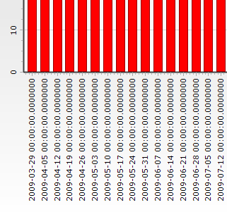

I'm trying to obtain the chart in the last picture from Captell in v3.5.3146 but I can't with the following code:
            tChart1.Panel.MarginBottom = 15;
            bar1.Marks.Style = Steema.TeeChart.Styles.MarksStyles.Value;
            bar1.XValues.DateTime = true;
            tChart1.Axes.Bottom.Labels.DateTimeFormat = "MMM dd";
            tChart1.Axes.Bottom.Increment = Steema.TeeChart.Utils.GetDateTimeStep(Steema.TeeChart.DateTimeSteps.OneWeek);
            Random rnd = new Random();
            for (int i = 0; i < 10; i++)
                DateTime date = DateTime.Parse("29/03/2009").AddDays(7 * i);
                bar1.Add(date, rnd.Next(100));

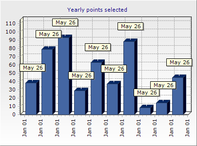

Ok, here is the code that reproduces the chart below using the latest released version of TChart:
            _testChart.Clear();
            var bar = new Bar(_testChart.Chart) {Marks = {Style = MarksStyles.XValue}};
            bar.XValues.DateTime = true;
            _testChart.Axes.Bottom.Labels.Angle = 90;
            _testChart.Axes.Bottom.Labels.DateTimeFormat = "MMM dd";
            _testChart.Axes.Bottom.Increment = Utils.GetDateTimeStep(DateTimeSteps.OneYear);
            var rnd = new Random();
            var date = DateTime.Now;
            for (var i = 0; i < 10; i++)
                bar.Add(date.AddYears(i), rnd.Next(100));
Note that bottom axis is set to automatic maximum and minimum, none of the points selected are from January, so the question is "Why January is showing up at all?" By setting increment to 365 instead of OneYear, setting Labels.RoundFirst to false and playing with axis Min/Max offsets I can get it to display the correct month (forget about dates!), but in my case it is not going to work, since my clients setup graphs using relative dates (year from today, 6 months from end of last month, etc.) and than print reports every month, or quarter without readjusting them ever after and expect to see the correct dates.

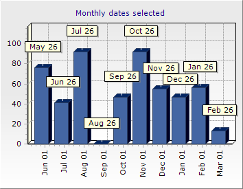

Here is similar problem with monthly dates:
            _testChart.Clear();
            _testChart.Axes.Bottom.Increment = Utils.GetDateTimeStep(DateTimeSteps.OneMonth);
                bar.Add(date.AddMonths(i), rnd.Next(100));

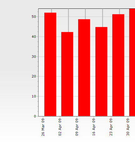

A) XValues.DateTime. The labels are automatically aligned as you expect if you set the property after populating the series, but before.
            bar1.Marks.Style = Steema.TeeChart.Styles.MarksStyles.XValue;
            //bar1.XValues.DateTime = true; //non-alignment
            tChart1.Axes.Bottom.Increment = Steema.TeeChart.Utils.GetDateTimeStep(Steema.TeeChart.DateTimeSteps.OneDay);
            bar1.FillSampleValues();
            bar1.XValues.DateTime = true; //alignment

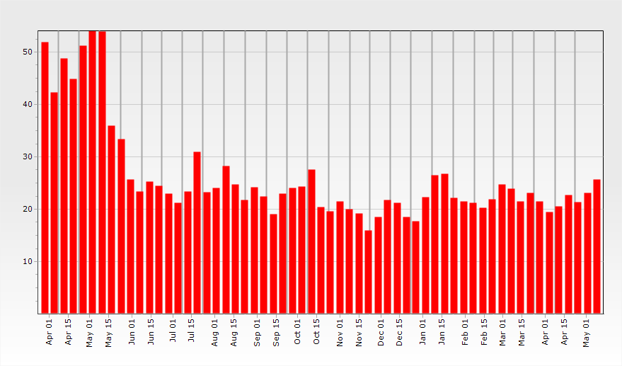

B) FillSampleValues. This automatic alignment only seems to work with FillSampleValues. If you change it for the following, the bottom axes labels are non-aligned again (regardless of XValues.DateTime place):
            DateTime date = DateTime.Now;
                bar1.Add(date.AddDays(i), rnd.Next(100));

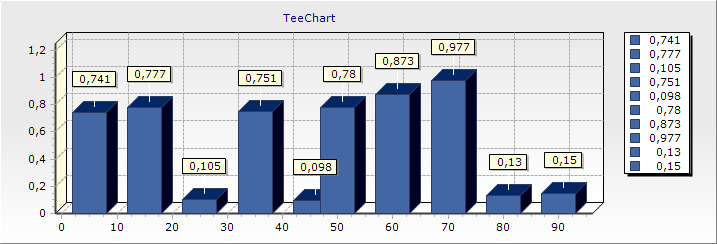

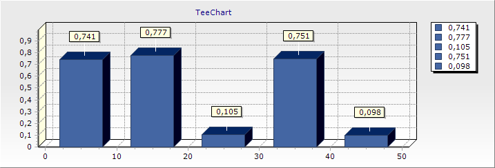

After studying the (TF02014914) issue, we concluded that (B) would be a designed behaviour rather than a bug. Let me explain:
The same happens with normal labels:
     tChart1.Series.Add(typeof(Bar));
     for (int i = 0; i < 50; i++)
       if (i % 5 == 0 && i % 10 != 0)
         tChart1[0].Add(i, rnd.NextDouble());
     tChart1.Axes.Bottom.Increment = 10;
If you don't specify where the labels should be drawn, we think one would expect them to be drawn at 0, 1, 2 etc, and if you set the increment to be 10, the labels should be at 0, 10, 20 etc. Where otherwise?
And furthermore, if you add more data, breaking the regularity:
            for (int i = 50; i < 100; i++)
                if (i % 10 == 0)
If we had changed axis labels to start drawing (5, 15, 25 etc.) they would now be "wrong" when new data added, right?
We could add a new property into axis labels (DrawAtPointValue or something similar) which would only draw labels on the axis where the series has a point. The problem will be that if there was a gap between one point and the next then there would be no axis labels. This is, in effect, identical to adding in point labels using the Series.Add overload.
