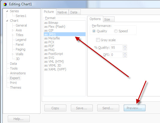

I just ran into this - and it is easy to duplicate.
Delphi 2009 - TeeChart 2010 - with full source...
1. Start Delphi - Start a new VCL Project
2. Add a TeeChart to the form
3. Add a new Series - TreeMap
4. Edit the Series - Go to Export - click on asJPEG - and then Preview.
At that point Delphi Freezes - and the screen greys out (As shown in the image below). I can duplicate this over and over :)
This seems to happen with other series and other export types as well.

Hi TimeAcct,
Thanks for reporting. I could reproduce this and added the defect to the bug-list (TV52014935) to be fixed. I have found that this works fine in Delphi 7.
