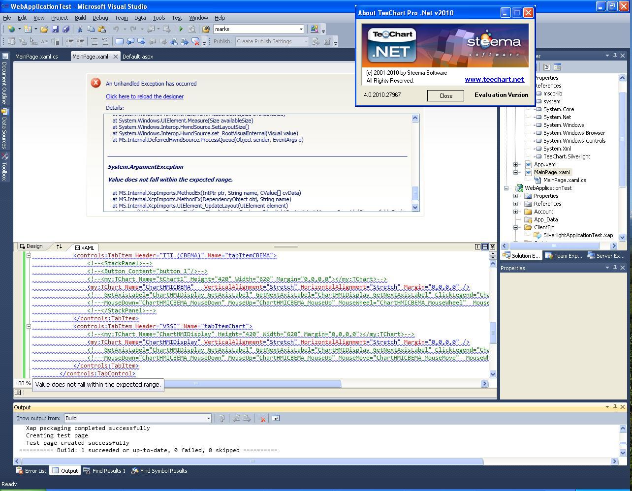

Post by BlueMonkey » Fri Jun 25, 2010 4:31 pm
Sandra,
I copied and pasted your code into a new project. I am not able to load the silverlight design page in the Visual Studio designer.
I am using Visual Studio 2010 (Version 10.0.30319.1 RTMRel).
I am using TeeChart.NET (Version 4.0.2010.27967 file version 4.0.2010.27966)
I get the following error if I do not provide a Height and Width property for the first TeeChart control:

System.ArgumentException
Value does not fall within the expected range.
at MS.Internal.XcpImports.MethodEx(IntPtr ptr, String name, CValue[] cvData)
at MS.Internal.XcpImports.MethodEx(DependencyObject obj, String name)
at MS.Internal.XcpImports.UIElement_UpdateLayout(UIElement element)
at Microsoft.Windows.Design.Platform.SilverlightViewProducer.SilverlightContentHost.MeasureOverride(Size availableSize)
Snapshot of Visual Studio with error

This problem seems to be specifically related to the Visual Studio design view. If I specify constant Width and Height properties, the design view appears and the application will run and display the fixed chart dimensions. If I remove the fixed chart dimensions (leaving the stretchable properties) then the design view gives the error "Value does not fall within the expected range.". However if I run the application in spite of the error in the design view, then the chart window will appear stretchable.
The conclusion is that if I want to see the design view of my GUI, I must supply fixed TChart dimensions. If I want to have a stretchable TChart in my runtime application, I must remove the fixed chart dimensions. I cannot have both.
It would be nice if the TChart would display correctly in the VS design view for both cases. Is this something you can fix?
Kent
