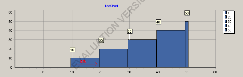

1. I can't comment the line b.setBarWidthPercent(100) since my plot is HISTOGRAM, not pareto.
2. What you suggested doesn't work. Here is similar codes as above for run as-is. In this code, I changed BottomMax=60, setCustomBarWidth=10, and set BottomIncrement=10(Optional, but it makes sense since histogram bar has same barWidth) to see more problems clearly. If you run the code below, you will see the following problems.
Problem 1. the width of the last bar is always smaller than the other bars width.
Problem 2. all bars except the last one are displaced as you can see the marks are not in the middle of bars.
Problem 3. not this example plot, but I can see a problem with another histogram, where bar width is not integer, but double. The data in histogram plot are distorted by casting double bar width to integer in order to use setCustomBarWidth(int)

Re: Histogram bars are shifted when x range is changed
Post by Yeray » Mon Jul 26, 2010 11:45 am
Hi Jonathan,
I see the labels aligned with their correct axis value. The problem is that, having barWidthPercent as 100, the right side of the each bar is changed and it moves to the next bar left side. That's why they look wrong.
What you could do to correct it would be setting a barWidth of the same size that the distance from axis value 10 and 20:
        b.setCustomBarWidth(b.calcXPos(1) - b.calcXPos(0));

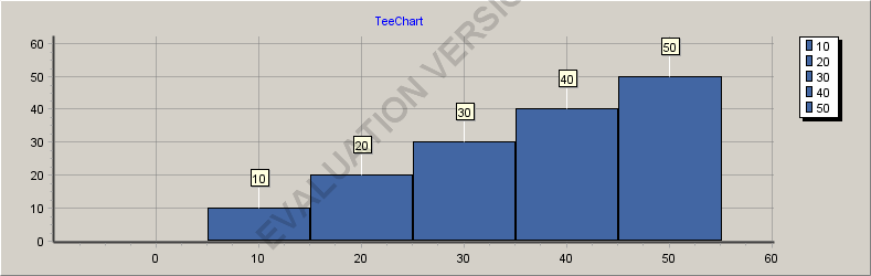

Post by Yeray » Thu Sep 16, 2010 3:34 pm
Hi Jonathan,
Excuse us for the delay in this issue.
We've been investigating this and found that adding a line in the TChart.java (swt) and some more changes in TChart.java (Swing) this can be done in the ChartPaintListener event.
Find attached both revised files and here it is the testing application for eclipse (swt):
