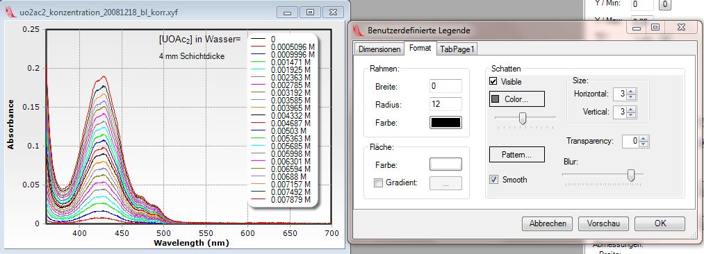

Settings will only applied when I change the shadow color by means of the trackbar. After doing so I get the following image:

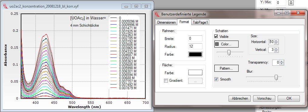

Now I change the Horizontal distance to 10 by means of the numedit, the shadow is not more drawn:
After changing the color trackbar a bit I get the shadow with the new settings applied:
