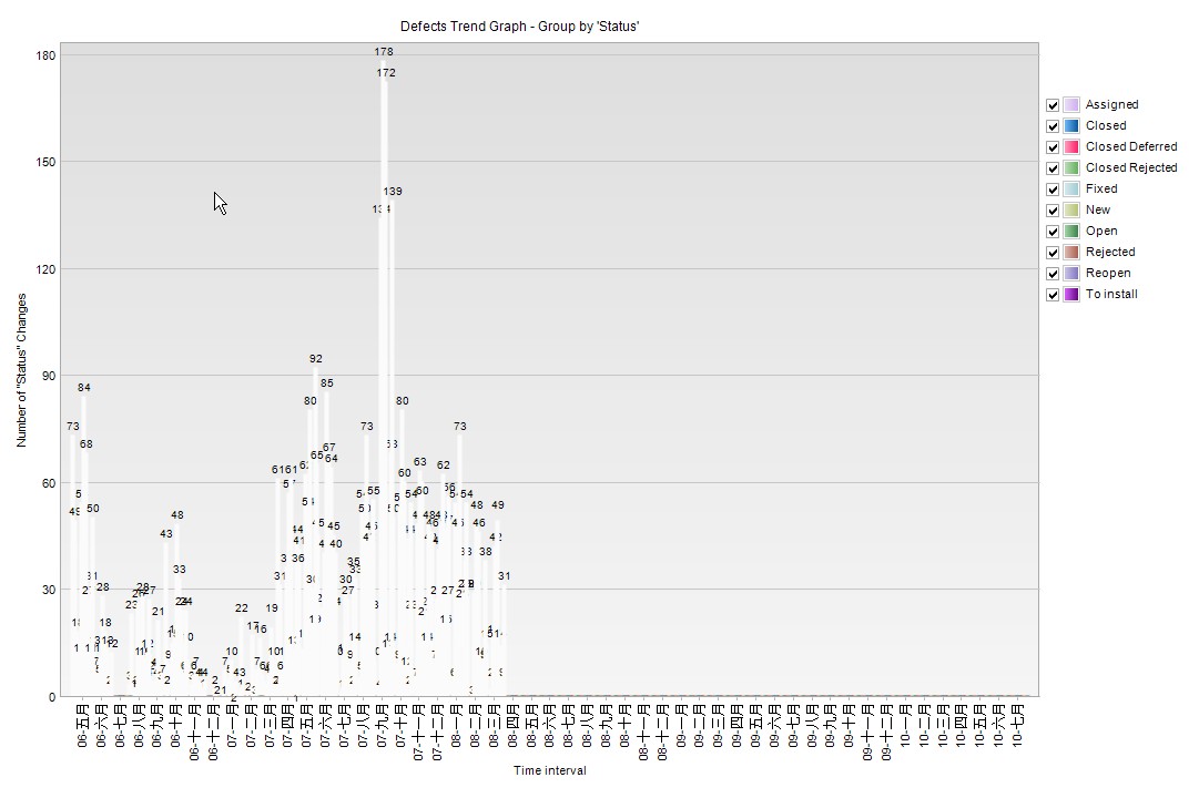

Perhaps I should elaborate on my problem a bit more.
Usualy, I'd like to draw the bars with a rather thick outline so I initialize my bars with:
 bar.Pen.Width = 2;
The problem is that sometimes my chart contains a lot of bars and so each bar is very thin. As a result the user can only see the outlines and not the bars themselves. Instead of seeing different bars with different colors the user sees all the bars in white (the outline color). You can see this in the image below: (Note that the legend shows various series with various colors.)

In such a case I'd like to reduce the outline width, something like:
bar.Pen.Width = 0;
If I change the width of the bar outline after draw, it only takes effect in the next draw (e.g. if I minimize the window and restore it again).
I'd rather not draw the chart twice (first time just to get the bars' width and second time to draw the chart with the correct border width) as this causes flickering and also because I'm afraid that draw may be an expensive opperation in certain situations.
My qustion is, is there a way to retrieve the bar's width and set the outline width according to it before draw? or pehaps there's a way to set the outline width to be relative to the bar's width?

I think you didn't understand. If I change the pen AFTER draw then this will be visible only in the next draw. I don't want to draw the chart twice because this causes flickering (i.e. the user can see the chart being drawn once with thick bar outlines and then drawn again with thin bar outlines) and also because it can take a long time to draw the chart.
What I would like is to be able to set the bar.Pen.Width according to what bar.BarBounds.Width is going to be without drawing the chart twice. I understand that the final bar width is being calculated only in draw. I was hoping that there's some way to know the bar width BEFORE or WHILE draw and set the border width accordingly. Perhaps some callback after the bar width has been calculated and before the chart has been drawn.
Is there any such way to set bar.Pen.Width according to bar.BarBounds.Width without drawing the chart twice?
