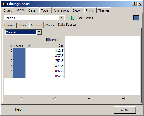

Easier:
1. Drop a Chart.
2. Open the editor.
3. Add a Series.
4. Go to the tab "Series/DataSource"
5. Choose "Manual" in the combobox to fix the random values.
