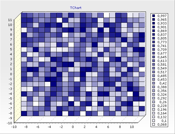

Re: Bug TColorgird TAnnotation Combination
Post by Narcís » Wed Apr 06, 2011 1:40 pm
Hi Andreas,
As I see the TColorgrid works in general not in inregular grid mode with negative values (althought the values are filled regular means äquidistant).
The colorfields are show only in the positive quadrant.
This restriction is a great loss especially because the very beauty smoothing function does not work in irregular mode.
Working with negative values would be a wish of mine for the next version, too.
I'm not sure about what do you mean here. Using TeeChart 2010 VCL (aka v9) here, which is the current TeeChart version, I get the chart in the image below which, in my opinion, works fine. Is this what you would expect?
It also works fine with SmoothBitmap enabled. You may want to have a look at the fully functional evaluation version of TeeChart 2010 VCL at http://www.steema.com/evaluation/vcl.
