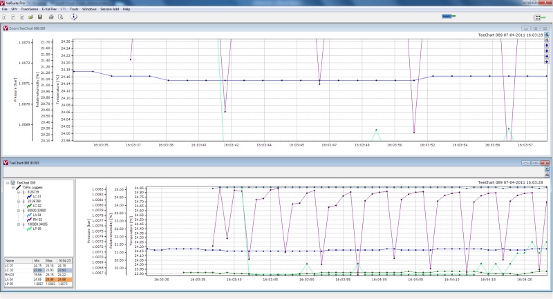

Perhaps I should also mention that when the user performs a zoom-gesture the zoomed area is shown in a separate window. Please see below
Now using
Steema.TeeChart.TChart.Zoom.ZoomRect(new Rectangle(x, y, width, height));
causes some problems. When zooming into a small time span the charts x-alignment goes off center
x-alignment off center

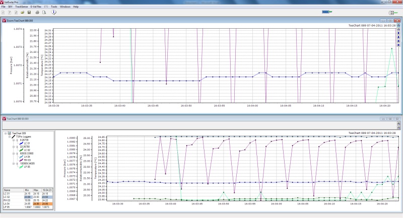

Doing exactly the same, but for a larger user defined zoom rectangle, everything look as expected.
x-alignment on center

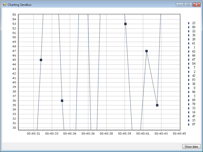

Another thing. Depending on how much the user zooms, the spreading of the x-axis grid becomes nonlinear somehow:
Nonlinear x-axis grid

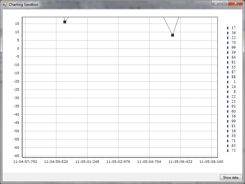

Anyhow – I’ve attached a simple Windows Forms VS2010 solution (ChartingSandbox.zip), taking use of our wapper class, and which will clearly show my problem. Just add your TeeChart.dll to the .. \ChartingSandbox\Ellab.Charting\DLL folder and it should build and run. Please let me know it you have any problems.
In the app, zoom in to approx 15 sec, and the series x-axis values are misaligned. Also the x-axis grid is not evenly spread. Both issues, as shown below..

Seems the problem is that the rounding of axis labels. You can check this, adding milliseconds and changing label format as next lines of code:
this.chartControl.HorizontalAxis.LabelFormat = "hh:mm:ss:fff";
Using it and doing zoom you will get next image:

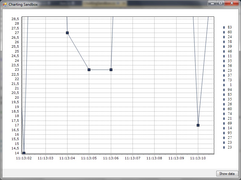

If you calculate the difference of milliseconds there are between values of labels of bottom axis, these correspond approximately one second. I think that a good solution for you would be fixing the DateTimeSteps to a OneSecond as do in next line of code:
 this.chartControl.HorizontalAxis.Increment = Steema.TeeChart.Utils.GetDateTimeStep(Steema.TeeChart.DateTimeSteps.OneSecond);
And you will get next image doing zoom that increments one second to one second:
