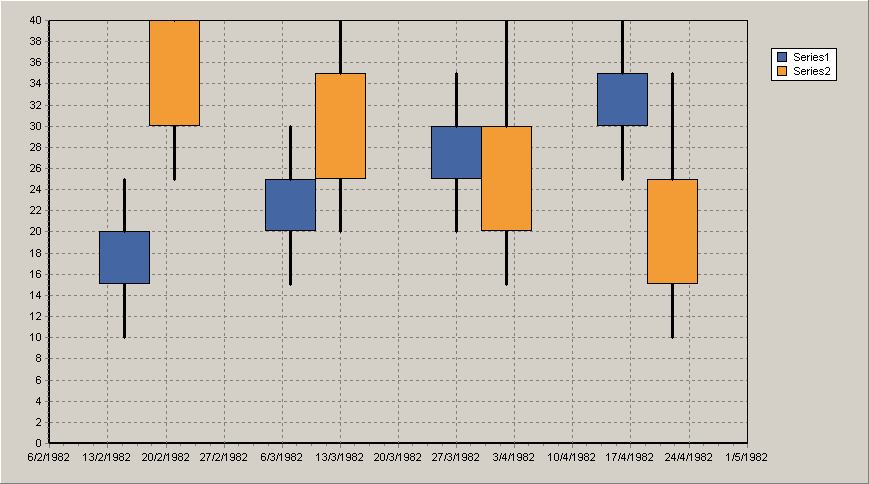

Post by Yeray » Fri Apr 22, 2011 8:07 am
Hello Steve,
Here's what I get with your code.
It seems that the left axis needs some adjustment, more than the bottom. You could calculate the min and max values and set them with the SetMinMax method or, alternatively, you could override the CalcVerticalMargins and CalcHorizontalMargins. Here you have the heathers:
Procedure CalcVerticalMargins(Var TopMargin,BottomMargin:Integer); override;
Procedure CalcHorizMargins(var LeftMargin,RightMargin:Integer); override;
FYI:
- You may want to change is the Bar series CustomBarWidth to make the bars a little thiner.
- To make the error lines wider you could change the Pen.Width instead of drawing three lines:
      ParentChart.Canvas.Pen.Width:=3;
      if ErrValHi[BarIndex]<>0 then with ParentChart.Canvas do
        DoVertLine(XPos,   BarHiPos, ErrHiPos);
      if ErrValLo[BarIndex]<>0 then with ParentChart.Canvas do
        DoVertLine(XPos,   BarLoPos, ErrLoPos);

Post by vas » Fri Apr 22, 2011 12:48 pm
This service is beyond fantastic.
I implemented your suggestions about CustomBarWidth and PenWidth.
But my chart results differs from yours. I suspect I have an install error in Delphi,
so I am likely linked to an earlier version. I cannot see TeeChart Help either.
In any case, I am close enough.
Thank you very much.
