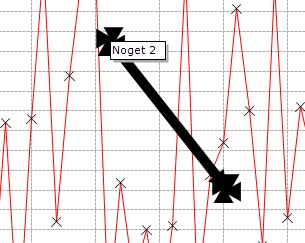

I found another workaround – in the NewLine event I set the sender.EnableDraw = false, and then create a new instance for each line I need.
Anyway – now I got another problem I can’t seem to figure out.
I would like the lines to be rather wide (10pix), resulting in that the ‘selecting points’ (I guess these are called Start- and EndHandles?) gets rather large (please see picture below).
Is the any way that I can set the size of these, or hide them, or ... (see next picture), makeing it look nicer? I know this is a rather dump question, but I just can’t figure it out.
Thanks a lot in advance
Christian

When I do a zoom, it doesn’t seems like that DrawLine From- and ToPoint gets updated. Is this a bug or am I doing something wrong/making the wrong assumptions?
