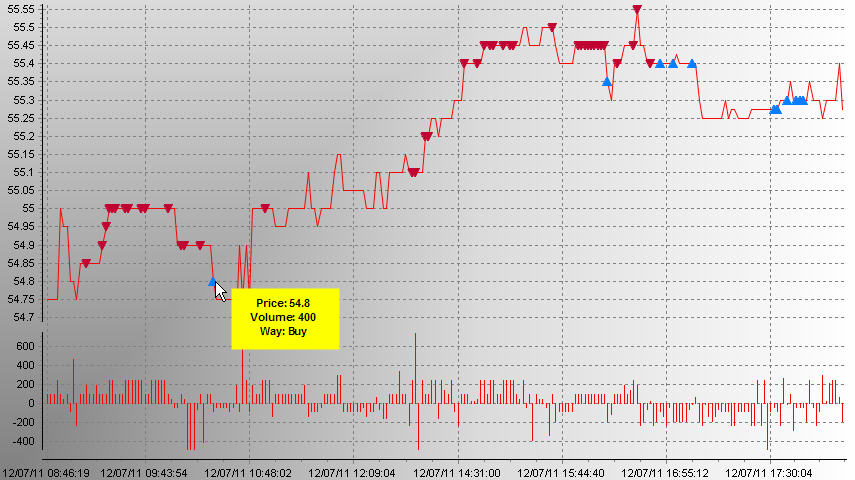

We would like to display tooltip when user move mouse cursor on our triangle Points(in down red or up blue here) (please look at our example)
In fact we would like to display only 1 mark on the mouse cursor position
How can we do this ?
Thank you for your help

The Rectangle Tool - MouseOverHints Demo is a good answer to my need but I don't want users could change the rectangle size...Is it possible to block this ?
Re: Display Tooltip on specific chart point
Post by Yeray » Wed Jul 13, 2011 9:16 am
Hello Guilz,
Yes, here there are a pair of properties you could be interested in:
  TChart1.Tools.Items(0).asRectangle.AllowResize = False
  TChart1.Tools.Items(0).asRectangle.AllowDrag = False
