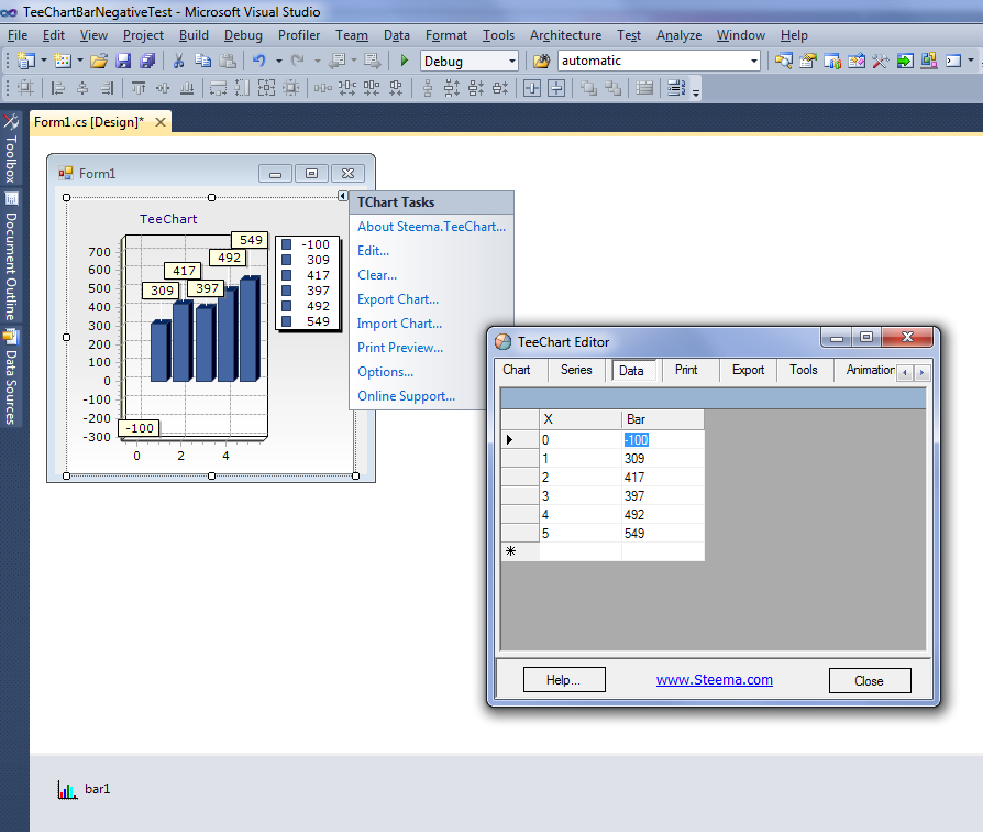

I've got the problem with Bar and Horizontal Bar series.
Whenever there is a negative value in the series, it is simply not drawn (not visible).
I'm using the latest TeeChart DLLs (4.1.2011.6283). The bug is present in both WinForms and WPF versions.
In previous versions, there was no such problem.
This is easily reproducible: just add the TChart to the Form, add Bar series, on the Data tab change any value to negative.
Screenshot is attached as a proof:

Hello neurosoft,
Thanks for your information. It is a problem known to us and was caused by us when we fixed the bug TF02014154.The solution that we considered good didn't treat the negative values and it wrong the Bar and HorizBar. We already fix this bug and it is solved for next maintenance release.
