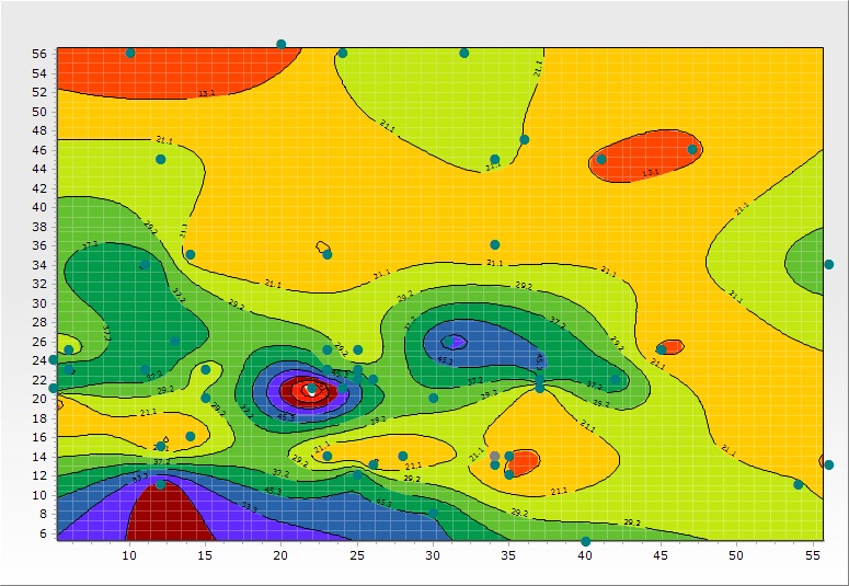

In Active X I could set .asContour.Smoothing.Interpolate = True. Is there a similar property in net?

The same property doesn't exist of TeeChart.Net tub I think you can do something as demo example All Features\Welcome !\Chart styles\Extended\Surface\Surface Smoothing. If you have any problems please let me know.

If I set smoothingmode=antialias, the contour map shows white grid lines?

Hi lilo,
This is the same you already found here. The demo example Sandra pointed you doesn't involve setting SmoothingMode to AntiAlias.
