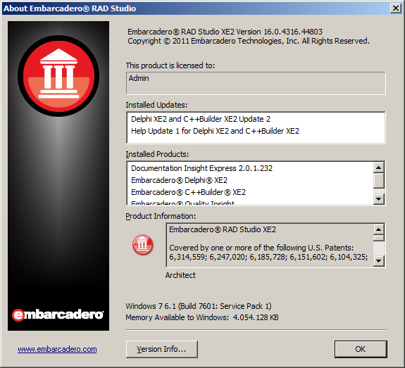

Re: TeeChart Pro for XE2 pre-release binary installer
Post by Yeray » Thu Nov 03, 2011 11:42 am
Hello Gregg,
What version of RAD Studio XE2 do you have?
Mine is 16.0.4316.44803:
Gregg
Posts: 11
Joined: Thu Oct 20, 2011 12:00 am
Location: Whatton-in-the-Vale, Nottinghamshire, UK
Post by Gregg » Thu Nov 03, 2011 12:23 pm
My version is the same as yours 16.0.4.44803.
