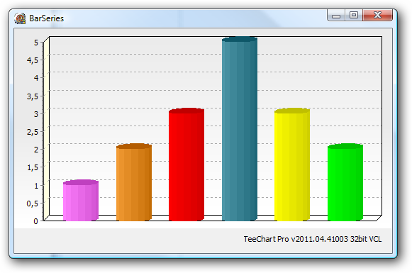

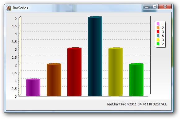

Anyway, although the property is a nice addition, but it makes the bar darker and it doesn't match the colours in the legend anymore.
Take a look at the images.
Also notice the light source. In the old version it looks as if it is coming from the left-front side. In the new version it looks there is a light source on the left and on the right.

Do you have enabled Dark3D? Is this a GDI+ project? We would appreciate if you attached a simple example project we can run "as-is" to reproduce the issue here.

Attached you find a simple application to reproduce it.

Ok, I could reproduce the issue here increasing the sides property in your project and added your request to the wish-list (TV52015912) to be enhanced for future releases.
