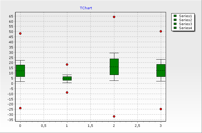

In the my Boxplot the outliers (shown as points) are colored by the chart itself and not by me. Does the coloring have a meaning?

The color of the outliers is taken from the series' color. By default, when a series is created, it takes the next color in the Opera Palette. That's why the outliers have these colors set, but you can change them as you want:
uses TeeBoxPlot;
var i: Integer;
  Chart1.View3D:=false;
  for i:=0 to 3 do
    with Chart1.AddSeries(TBoxSeries) as TBoxSeries do
      FillSampleValues();
      Position:=i;
      Box.Color:=clGreen;
      Color:=clRed;
