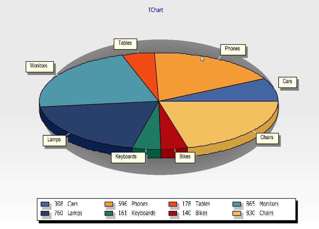

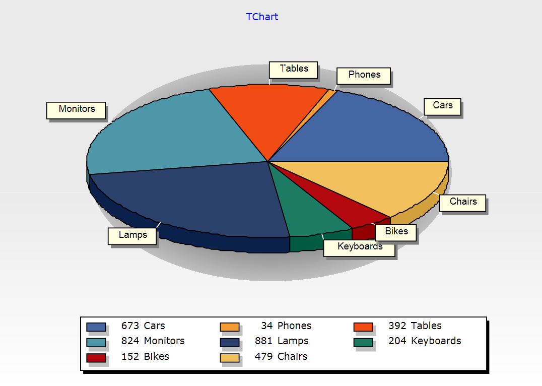

I encountered an issue whith the fonts when printing with TeeChart Pro 2011 for Delphi XE2.
With Delphi 2010 the printed export looks as expected:
With Delphi XE2 the fonts of the legend and the hints looks very strange:
I use TChart.PrintPartial() for printing.

I don't get strange fonts as you did using the code you posted.
Please take a look at the printed chart with common canvas:
And here the printed chart with gdi+ canvas:
The printed font in the hints and legend looks quite strange.
